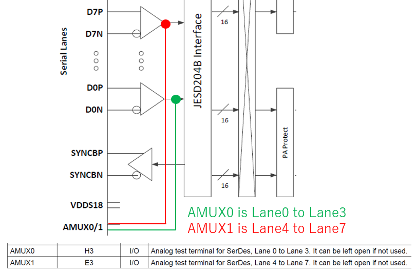

[AMUX0 and AMUX1 pins]
I understand that AMUX0 and AMUX1 pins can measurement the internal SerDes lines.
Is my understanding correct?
If yes, could you please let us know the measurement point in the IC internal?
<My image>
    Yes, this is to provide internal measurement points for the SerDes IP. The probe points includes some bias nodes such as bandgap generation and various SRX biases. Normally we do not need this for debug so unless it is absolutely necessary, TI will not disclose this.
