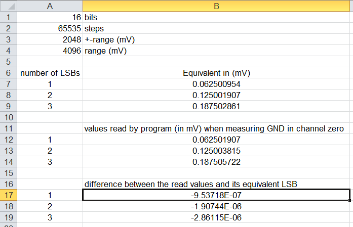

    But I still have one error on my calculations. If you open the following attached file, you will see that, according to my calculations, the LSB is not exactly equal to the output value (0.0000625019074068) . Do you have any idea why?

  • Hello again
    Sorry, I was not  finding the clip icon
    please check if you can open this document and if so, please help me understand why is there this difference
    ThxADS1115 calculations.xlsx

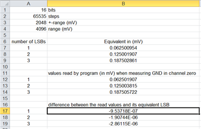

  • David,
    Thanks, I see what you're talking about. I've clipped out the excel spreadsheet to show it here:
    First, I would point out that the difference from one LSB to the next is less than 1nV (you have basically have a difference of part in a million of 1mV). This difference comes from a small error in representing the number as a full scale. The LSB is approximate because of the difference between the number of negative and positive numbers in what we represent as negative and positive full scale.
    For this device you use 16 bits to represent the full scale. Here there are 2^15 negative numbers, one representing 0, and then 2^15-1 numbers representing positive numbers, so it's not symmetrical. If you used the output data times the 0.0625mV number, you'll come up one LSB short and you'll never perfectly reach positive full scale because there's no way to represent it the same way for positive to negative. Most of the time, we just use an approximate value and any errors are much smaller than the gain error.
