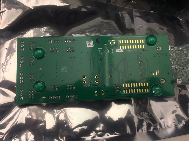

I want to enquire if ADS131M08EVM is compatible with Launchxl-F28379D when connected as BoosterPack. Also, I want to ask about J11 and J12 pins, are they readymade slots. Can you share the below side image of the board?

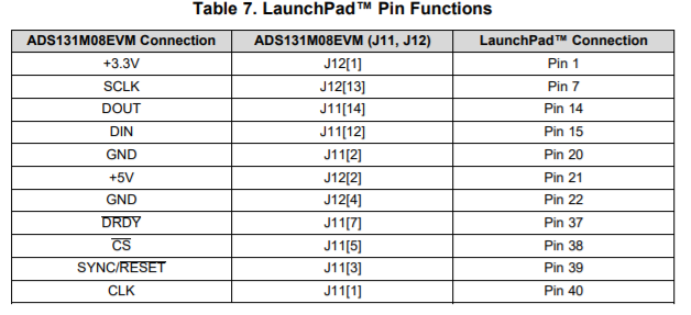

    I ran a quick check based on the ADS131M08EVM pinouts through J11 and J12. Here, you can see the Launchpad pin mapping from J11 and J12 of the EVM:
    From this, I had a json file that I've created for the ADS131M08E can use to verify the booster pack from this site:
    https://dev.ti.com/bpchecker/#/
    Here you would select the LAUNCHXL-F28379D as the launch pad, and then use the json file for the booster pack (you'll need to load this file for the booster pack and make sure the Category and Maker is set to all. Then you can go back and look at the Compatibility Checker:
    From this, you should be able to plug the two together.

  • Mohammed,
    In case you still need a picture of the bottom of the EVM, it looks like this:
    Also, for the link in the previous post, you would open this up as a text file, but save it as a *.json file. That is how the checker uses the file.

  • Hello joseph,
    Thanks for forwarding the picture.
    After looking at te bottom, I see there is a non existence of connecting female slots on J11 and J12, which is a connection issue for us.
    So how do we populate these pins onto my launchpad, do we have to consider soldering?..or do we have some sort of connectors in the market which will solve the connection issue.
    And if requested, can these pins (J11 n J12) be mounted with connectors before packaging n shipping to us.

  • Mohammed,
    For J11 and J12, you would need to buy the appropriate connector and solder them on yourself. We wouldn't be able to assemble that for you. The connectors can be found in the ADS131M08EVM User's Guide in the Bill of Materials (as an unpopulated component):
