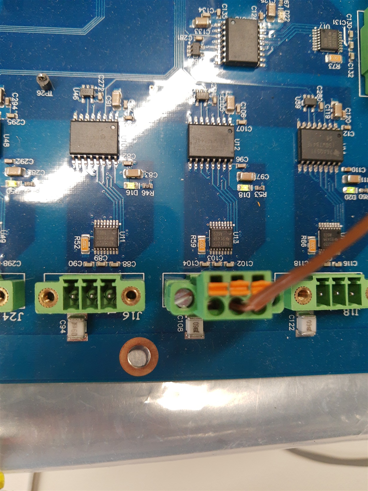

    We are using a Fluke 714 thermocouple calibrator attached to thermocouple wire to our connector on the board.  I have included an image of the distance between the connector and ADS1220.

    The layout looks to be good.  The ADS1220 internal temperature sensor should be quite accurate to the cold-junction temperature.  The picture you sent only shows 1 wire at the connection block.  I guess I'm still not quite sure how you are inputting the voltage from the calibrator to the ADS1220.
    Schematically I see you have pull-ups and pull-downs on the input.  However the value is 100k, which might cause some issue with self-heating of the TC.  Also, you have 10nF caps for both the differential and common-mode caps at the input.  The differential cap should be 10x greater in value than the common-mode caps.  The reason is to limit any drift due to mismatch of filter values causing an error in measurement.
    I also see you have an inductance between the DVDD and AVDD sides of the ADS1220.  We have seen that in some cases added inductance can cause issues even when using a ferrite bead choking required current at times the analog portion of the device is powering up circuits.  The ADS1220 current is not static but is dynamic.  I would suggest replacing the inductance with a small value of resistance if you require some supply filtering.
