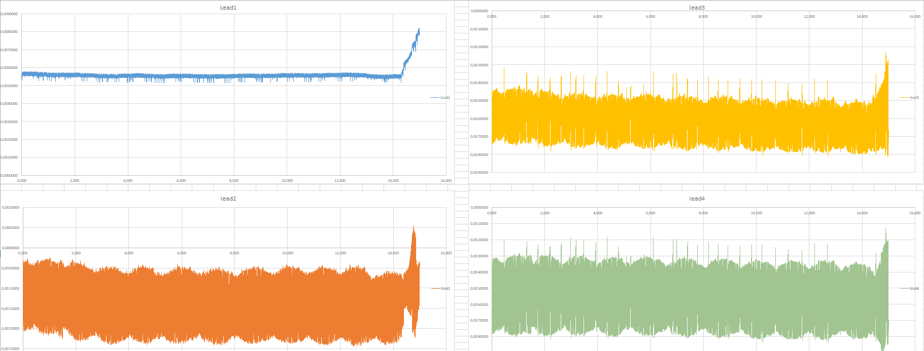

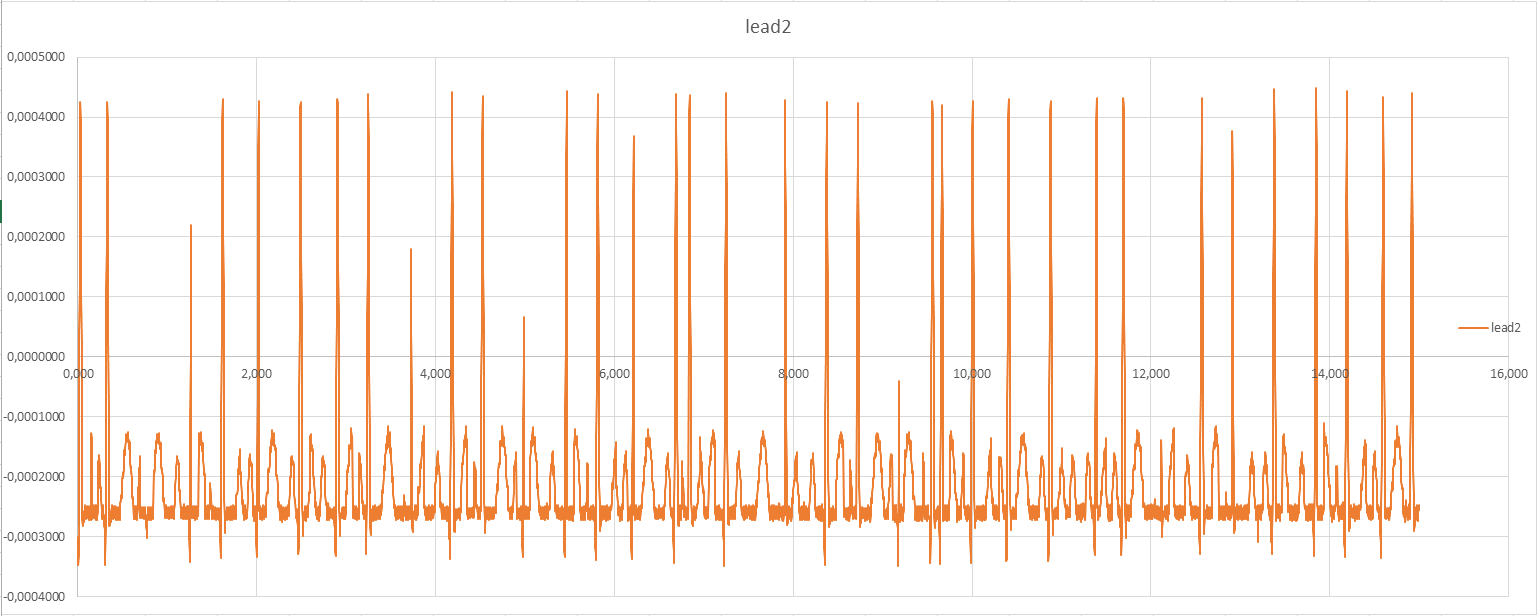

My company is developing a product, with the main purpose of acquire a 3 lead ECG signal from a patient t-shirt. For that, I'm using a ADS1294R. So, my main problem here, is: when i connect my product to a ECG simulator ( Model: AMPS-1 | S/N: PS08060041 ) I can actually see the ECG graph with low noise like you see in the image bellow:
But, when I connect it to my shirt/eletrodes, I cannot see anything good. The next image show the Real ECG measurement:
I'v tested different electrodes in different locations, but nothing seems to work.
I've review all the software and hardware and nothing seem to be discordant with the datasheet information. However, its my first time, working with this kind of technology, so I may be missing something. I would like you to review my hardware and software configurations and, possibly, help solve my problem.

    If the difference in signal quality is noticed between the patient simulator and a real patient, my assumption would be that the large contact impedance of the dry electrodes is the main issue. Dry cloth electrodes will have much larger contact impedance. This can result in attenuation of your ECG signal. In addition, differences in contact impedance will create a more noticeable common-mode to differential noise conversion, which will mask the signals of interest.
    We cannot provide much insight into the impedance of the electrodes you're using as we're just don't have the expertise. However, I did review your schematic and one thing I noticed was the very low closed-loop bandwidth of the RLD amplifier. The 1M||100nF sets the bandwidth to 1.59 Hz, meaning none of the 50 Hz / 60 Hz common-mode noise is being rejected by the RLD loop. Please decrease the cap to 1.5nF. This may not completely solve the issue, but it should help reduce the amount of 50Hz/60Hz noise in your measurements.

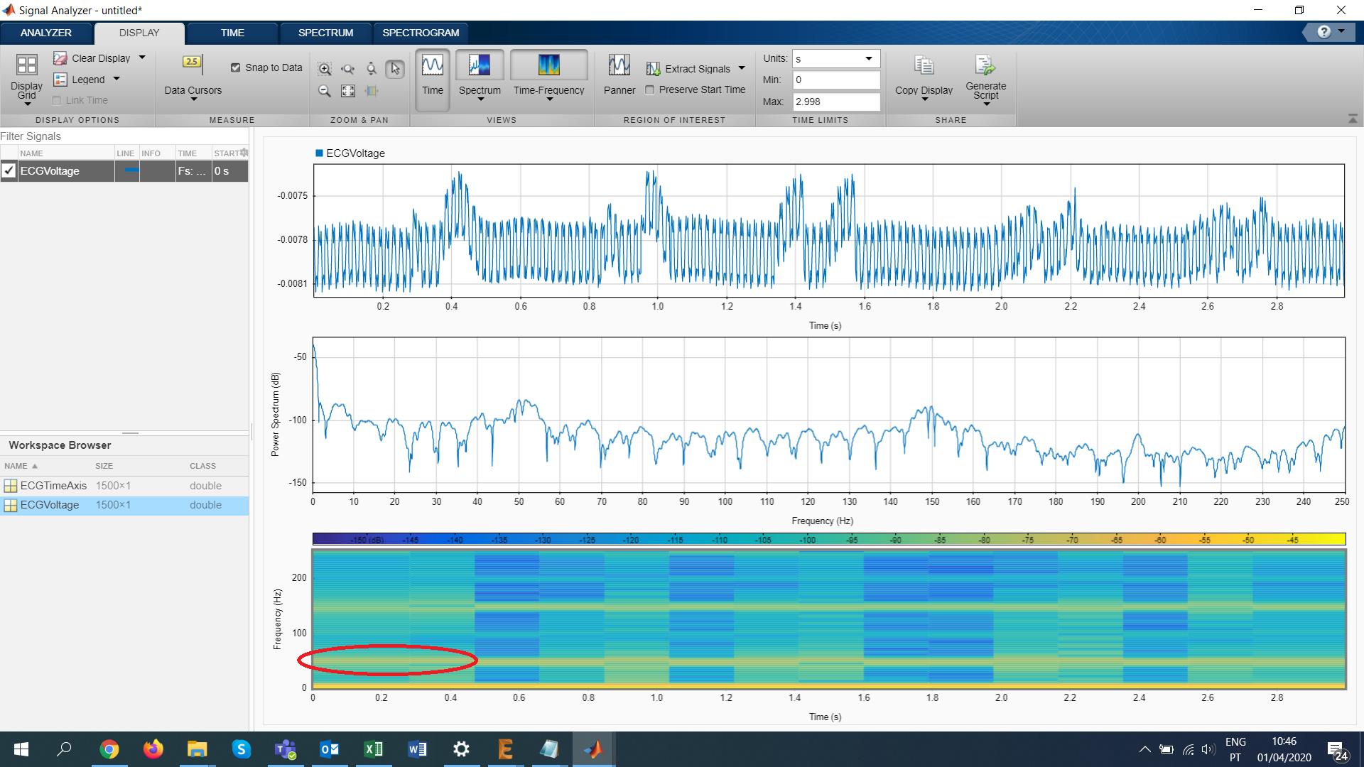

    An update from our talk: I brought some new electrodes and test them again in the better position possible. These ones have some kind of gel for better conductivity.
    However, results were almost the same:
    So, I thought on what you wrote about the RLD not not being able to eliminate the 50 Hz noise, but, with the patient simulator, we can, at least see the ECG graph, so I presume that the ADS must be doing some kind of filtering right?
    I'm really running out of options here. I've tried everything. I even built a acquisition signal on a breadboard, tried different kinds of filters, different kind of electrodes and nothing seems to work. Do you have any suggestion on what to do next?
    André Vaz
  • Hi Andres,
    Gel electrodes do lower the contact impedance and should help improve the signal quality. Still, it's possible for a lot of 50-Hz noise to couple onto the body, whereas the patient simulator is shielded and provides a much cleaner signal source to begin with.
    The ADS1294R is not providing much filtering to 50-Hz noise. At 500 SPS, the digital filter has a -3-dB cutoff of 131 Hz.
    In the analog domain, the best you can do is to use shield the cables and circuit board. Also, you need to preserve high CMRR through the analog signal chain by matching input impedances and applying the RLD. A breadboarded circuit is not good for sensitive low-noise measurements as they can be very noisy.
    In the digital domain, ECG applications almost always rely on some digital signal processing to filter out the remaining power line noise.
