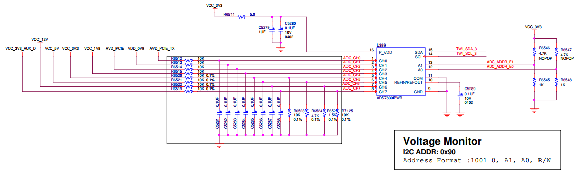

Hi Team,
Customer used ADS7830 to monitor the voltage and find the error this lightly large. Could check if the data is right or have a way to optimize?
We verified ADS7830 function on two units - compare the actual voltage measured at ADS7830 pin and the voltage reported by ADS7830
Test results on some channels exceed ADS7830 accuracy spec. See attached file for details.
Column B - Actual voltage measured at ADS7830 pin
Column D - Voltage reported by ADS7830
Column E - Difference between two voltages above
Our design is as below.
Could you help to check and advise the reason for the failures?

    Would you please explain how the max and min specs were come to?
    I believe what you are looking for here is the total unadjusted error; there is a great three part blog explaining the topic of ADC accuracy, in particular part 2: total unadjusted Error, that I believe would directly address this issue.
    I also notice that the difference between the pin voltage and ADC output is greater than half an LSB. the ADC should settle to half of an LSB or less. This could also be leading to the greater than expected error.  When using the internal 2.5V, the LSB= 12.89mV, which then means settling goal for the input is half = 6.445V. This would mean that the ADC will output a value reflecting the input, and not be codes off.
    What sampling rate is the devices running at? A quick check to see if it is a settling issue, is slowing down the sampling rate, if the measurements become closer to the expected voltage then it is a settling issue. If so, I would suggest lowering the sampling rate if possible, if not, then we can work together to change the RC filter values to allow for proper settling
    Cynthia
  • Hi Cynthia,
    Please refer to my comments and further questions below. Thanks.
    1) Would you please explain how the max and min specs were come to?
    The specs were calculated based on the equation in the link you shared.
    A recommended way of calculating the maximum TUE at a particular analog input voltage is to take the root-sum-square (RSS) of the maximum values of all individual errors at that point ,(Equation 1).
    The root-sum-square result is -0.71 LSB ~ +1.225 LSB.
    Would you please advise if any concerns on this result?
    2) When using the internal 2.5V, the LSB= 12.89mV, which then means settling goal for the input is half = 6.445V.
    According to previous discussions with TI FAE, the LSB of ADS7830 is 2.5V/256 = 9.7656mV. Would you please advise how the 12.89mV LSB is calculated?
    3) What sampling rate is the devices running at?
    The I2C frequency connecting to ADS7830 is 400k. The host will polling the voltage from ADS7830 every 5s.
    Suppose you are suggesting to change the I2C frequency from 400k to 100k, not enlarging the 5s polling period. Would you please confirm this?

  • 1. Can you share exactly what numbers are used here?  I am not getting the same numbers.
    I am using  the following and get slightly different results of  +/-0.52LSB and +/-1.32LSB.
    On top of this, please also note that the internal voltage reference has a max and min of 2.48V to 2.52V that is 20mV in either direction. the TUE does not consider the reference not calibration. the customer can measure the actual voltage at the REF pin, and use that value to interpret the ADC measurements.
    Squared
    Spec Min Max Min Max
    INL -0.1 0.5 0.01 0.25
    DNL -0.1 0.5 0.01 0.25
    offset 0.5 1 0.25 1
    Gain -0.1 0.5 0.01 0.25
    Sum 0.28 1.75
    TUE 0.52915 1.3228757
    2. You are correct, I was using the wrong resolution size. for 8 bits, and full scale of 2.5V. the LSB is = 2.5/2^8 = 2.5/256 = 9.765mV
    3. I would suggest looking at question 1 first, before trying the below.
    You do not need to change the clock rate, thus the throughout will remain the same. What will need to change is the time between the command byte to the device and the next read address byte. When the device receives a command byte, the acquisition mode begins when BIT 4 is received, this is when the input is being sampled, elongating this time will allow for longer settling time. the acquisition time ends with the next read addressing command.
    Cynthia

    To address the resolution question, it is not a matter of codes, 255 vs 256. It has to do more with rounding.
    2.5/255 = 9.8mV
    2.5/256 =9.765mV
    The device probably cannot reach into the microvolt level, thus rounded to 9.8mV
    The blog was trying to simply in effort to keep the write up short, thus only used three of the four, but the INL and the DNL should both be included. In equation 1, there are "…" to indicate there are more, the equation is just shortened for simplicity. but all four DC specifications should be used.
    In the document, Glossary for ADC Specifications, the Total unadjusted error shows all DC specifications, offset, gain, INL and DNL.
    Regards, Cynthia

  • 1. I agree with you that it is more precise to use the 9.765mV as LSB, but if the device cannot support that level of accuracy, then it is not sustainable to use that value. I had not seen the note previously, until you pointed it out. I am working to get some insight into this from the design team, but I predict that the LSB value to be used is 9.8mV as stated in the datasheet.
    2. It would be: voltage reported by IC > actual voltage
    3. The DNL is needed to measure the INL, perhaps this is the confusion. Also, in delta sigma ADCs, the DNL is not used because of the nature of the device. But in SAR ADCs, they are still two different measurements, and each should be considered.
    Cynthia

    1) I tried to debug on CH3 by changing the in-series resistor from 10k to 1k, but there is no improvement on the voltage deviation.
    2) I would like to try some more resistance/capacitance for further debug as your suggestions. Would you please advise the recommended resistance and capacitance for ADS7830 application? Or a resistance/capacitance range based on TI's best practice, then I can try it.
    Thanks.

    Thanks for your suggestions. As you pointed out, there is deviation of ADS7830 internal reference 2.5V voltage, in a range 2.48V~2.52V.
    I measured the reference voltage at ADS7830 pin10 on the 2 failed units. Both are not exact 2.5V - one is 2.5154V and the other is 2.5102V. This should be the cause of the voltage deviation issue.
    Use one failed case for example:
    For failed unit CH6, the register is 9F(Hex), while the measurement voltage is 1.5693V.
    In our software, 1 LSB is defined to be 2.5V/256 = 9.765mv, then the reported voltage is 9F(Hex) x 9.765mv = 1.553V. The voltage deviation is 1.5693V-1.553V = 16.3mv > TUE spec
    If calculated with 2.5154V reference voltage, 1 LSB = 2.5154V/256 = 9.826mv. Then the reported voltage is 9F(Hex) x 9.826mv = 1.562V. The voltage deviation is 1.5693V-1.562V = 7.3mv < TUE spec
    Would you please advise if my understanding is correct?
    If yes, here comes the two new questions:
    1) How could our software get the actual internal reference voltage value for calculation? Is there a register to report the actual internal reference voltage value?
    2) How to minimize the internal reference voltage deviation from 2.5V? Considering the worst case, the internal reference voltage is as worst as 2.52V. There will be 20mv deviation, which is even higher than the TUE spec!
    Thanks.
  • Your understanding is correct, I am glad the source was found.
    There Is no internal register with the reference value unfortunately.
    One method is to use an external reference to provide the voltage, and use a reference that meets the need of the systems
    Another method is measuring the reference with one of the inputs of the device, such as ratiometric measurement, that way any deviation in the reference voltage can be followed.
    Cynthia

  • Hi Cynthia,
    I am a little confused for this statement. Would you please help to explain more details?
    It would be best to design the input and input drive to introduce the least error as to not be impacted by the reference.
    Not sure if your suggestion is to optimize the circuits of ADS7830 input channels (CH0-CH7), in order to reduce the impact caused by ADS7830 internal reference voltage deviation.
    To my understanding, the input circuits optimization only helps to reduce the unadjusted error, to make ADS7830 calculation result close to the minimal TUE spec, 0.529 LSB.
    However, the additional error caused by ADS7830 internal reference voltage deviation (compared to 2.5V) is independent to the unadjusted error and cannot be reduced.
    In other words, the input circuits optimization only helps to reduce the errors marked in blue color, but has no benefits to the errors marked in red color. (see table below)
    Please kindly correct me if I did not get your point correctly. Thanks.

  • Your understanding is correct.
    I was trying to say is to limit dependency of the reference voltage for the input to be within TUE limits.
    Cynthia
