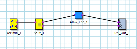

Receiving audio data from AIC3254 with alaw compression in miniDSP. I create the next scheme in PPS:
That is correct?

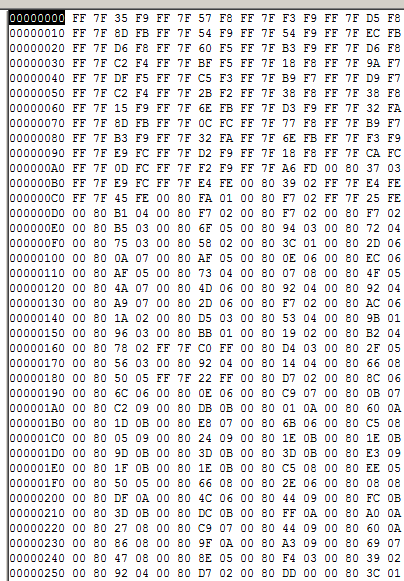

Next, I connect to mic_in the signal from the native sound card of my computer and write wav file (my settings - 16 KHz 16 bit). But I receive the next picture:
I'm confused with this. For example, _F935 -> 7FFF_ and _04B1->8000_. I'm not understand why.

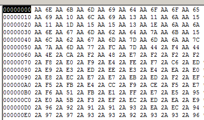

After that I try to compress this file to alaw format by other program, and I get next results:
 For example, _7FFF -> AA_ , _F935 -> 6E_, _8000->2A_ and _04B1->96_. This is correct... but why the data from alaw module (from miniDSP) isn't correct?
