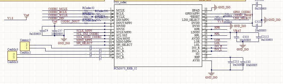

Hello all,
I made my own prototype board, using a PCM3070 connected with a MSP340 via a spi bus. I checked the signals of the spi, and they look ok using an oscilloscope. The problem is that pcm3070 don't confirm the data after being written with the MISO.
I checked voltage, and grounding. All are ok.
What could be the trouble?
Thank's you in advance
ip
  • Hi Ignasi,
    Pin 12 is the SPI_ SELECT pin, this determines if I2C or SPI communication is used. If this pin is high it will be in SPI mode, if low then it will be in I2C mode. What setting do you have this pin at?
    Justin
  • Hello Justin,
    SPI_SELECT is 1.
    Thank's for your help,

  • And the codec pcm3070 is connected with this schematics :

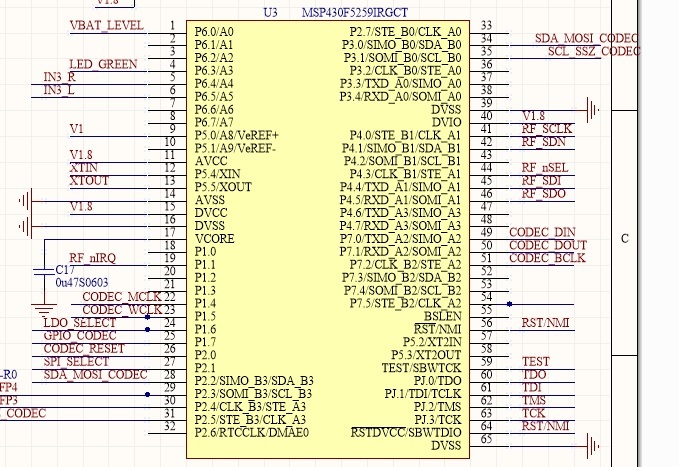

  • And the microcontroller . I cannot make them to communicate properly.
  • Hi Ignasi,
    It seems you are setting the SSZ pin as an input on the MSP430, this pin must be driven to let the PCM3070 know when SPI communication is coming. Please read section 2.7.2 in www.ti.com/.../slau332.pdf
    Justin
  • Hello Justin!
    Thank's for your help. After another reading again the section 2.7.2 it is clear for me that ssz must be driven. The problem I have right now, It is I don't know how to implement it on my code. Could you help me on this? A simple GPIO_setOutputHighOnPin() should work? If so, where should I implement it?
    I changed the port to output with the function GPIO_setAsPeripheralModuleFunctionOutputPin(), but it still doesn't work. Any other bugs?
    Thank you all for you help,
    ip
  • Hi Ignasi,
    The application document states:
    "The SSZ pin can remain low between transmissions; however, the PCM3070 only interprets the first 8 bits transmitted after the falling edge of SSZ as a command byte, and the next 8 bits as a data byte only if writing to a register."
    So you need to create a falling edge on the SSZ line at the start of every transmission.
    Justin
  • Dear Justin,
    So in the code below, how should I create the falling edge on the ssz line?
    //PCM3070 SPI SS
    GPIO_setOutputLowOnPin(GPIO_PORT_P2, GPIO_PIN5);
    But it doesn't act as a falling edge. Where should this line be?
    Thank's you a lot in advance.

  • Hello Justin,
    Could you please confirm me that you don't see any design problem on the PCM3070? Voltage, Grounding, Capacities.... In case it doesn't work because a wrong wiring...
    Thank you in advance!
    ip
  • Hi IP,
    I have looked over the schematic again and I have a few comments:
    -many of the mode select pins are driven by the MSP430, so making sure they are set correctly with a probe when testing could be helpful. (along with the SS pin)
    -You are supplying AVDD with VBAT, is this a regulated supply?
    -I don't see any filtering on the input, only DC blocking caps, unless there are filters elsewhere.
    Everything else looks good.
    Justin
  • Hello Justin,
    Thank's again for your support.
    - I have tested the selected pins driven by MSP430, and they are all ok, related to configuration.
    - AVdd is a regulated supply. On my case, regulated 1.8V
    - Filters are on another part of the design. On the board, they are close to codec.
    I couldn't have any help on MSP340 forum. From my side, I just had some advances, I could see my spi signals on oscilloscope, so spi is alive. The thing is I try to configure a single beep on the outside, to confirm it is alive. But I couldn't. With my actual spi bus I still cannot program the registers. Maybe spi parameters are wrong?

    I'm also afraid, if code is ok, but configuration is not good and I cannot know where the codec is...
    Best Regards and Thank's for your help
    ip
  • Here the information on filtering stage :
  • Hi IP,
    I believe there is a difference in meaning between SPI settings in the MSP430 documentation and the PCM3070 definitions. Try changing the following code:
    From:
    UCB3CTL0 |= UCMST+UCSYNC+UCCKPL+UCMSB; // 3-pin, 8-bit SPI master
    To this:
    UCB3CTL0 |= UCMST+UCSYNC+UCMSB; // 3-pin, 8-bit SPI master
    If this does not correct the SPI communication I would suggest using the EVM and using your script through one of our GUIs to test the script itself without the complication of the SPI communication.
    Justin
