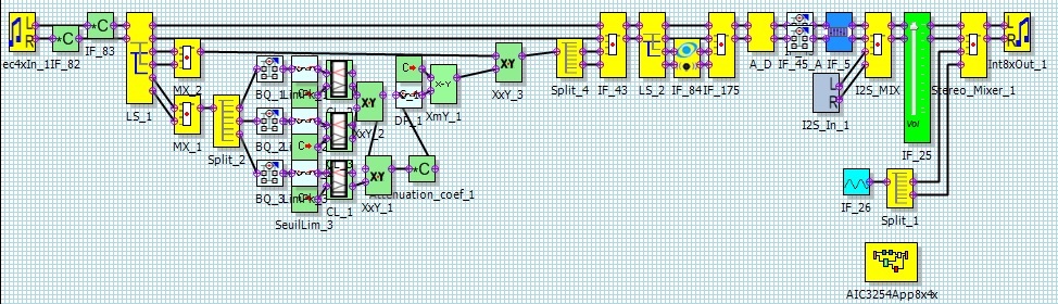

Hi everyone,
I've been using the TLV320AIC3254 with 2 differential mic inputs (Left = IN2L - IN2R and Right = IN1R - IN1L) for 2+ years and it worked well upto now.
The two omnidirectional mics help for some treatment and are finally summed to the output.
However, my last production came up with a weird inverted input (left) ! Making my mics behave as a bidirectional sensor after summing !
The PCB's are stricktly identical and the program of the PIC which configures the codec on power-up is also the same...
Here I have 2 identical boards with the same program, but they do not behave de same. Then I have to put a software -1 coef on the left channel of the last production if I want it to work as the first ones.
Where do you think it comes from ? Even the last datasheet update doesn't state anything about this...
Do you have an idea to identify the boards which need -1 within those which doesn't.  ?

  • I use PurePath Studio, then here are the framework properties you think about :
    miniDSP_A_Cycles = 1024
    miniDSP_D_Cycles = 1024
    SynchMode = disabled
    Samplerates = 44.1kHz

    Thanks for advice.
    Howevere, I don't get the first point :  page0/reg27 is written 0x0C, then D3 and D2 only are high. You advise me to put 0x01 instead, it still keeps D1 at 0 (unchanged) but it modify DOUT Impedence, BCLK and WCLK... Why ?
    I'm not sure about what I should care about with your second point...
    Finally, for your third point, I already use an interprocessor component in my process flow (A_D on the top right), then i just turned off loopback to see. It doesn't have any effect neither on the previous nor on the new production. Still got an inversion somehow (need I_83 to change opposit) !
  • Hi Maxine,
    You are right about the first point. I somehow got confused thinking 0x0C as 0x03.
    My recommendation is to try as much as you can to isolate the problem. You can accomplish this several ways:
    1. Start by creating a simple process flow: Dec4xIn > DSP_A_DSP_D > Int8xOut.
    2. Use the default SystemSettingsCode with as little modifications as you can (except for BCLK/WCLK as outputs, etc.). The default SSC will also contain analog configuration of the device as well.
    3. Connect EVM I2C lines to end-system I2C lines and download the code from #2.
    4. Input an 18kHz tone to both inputs (I assume you use 44.1k or 48k sampling) and observe output to check phase.
    5. If phase is correct, download process flow from #1 with your custom SystemSettingsCode to see if the issue is the processing or the register settings.
    J-
