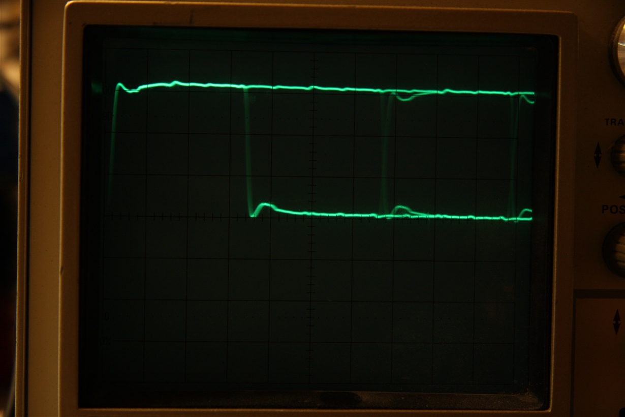

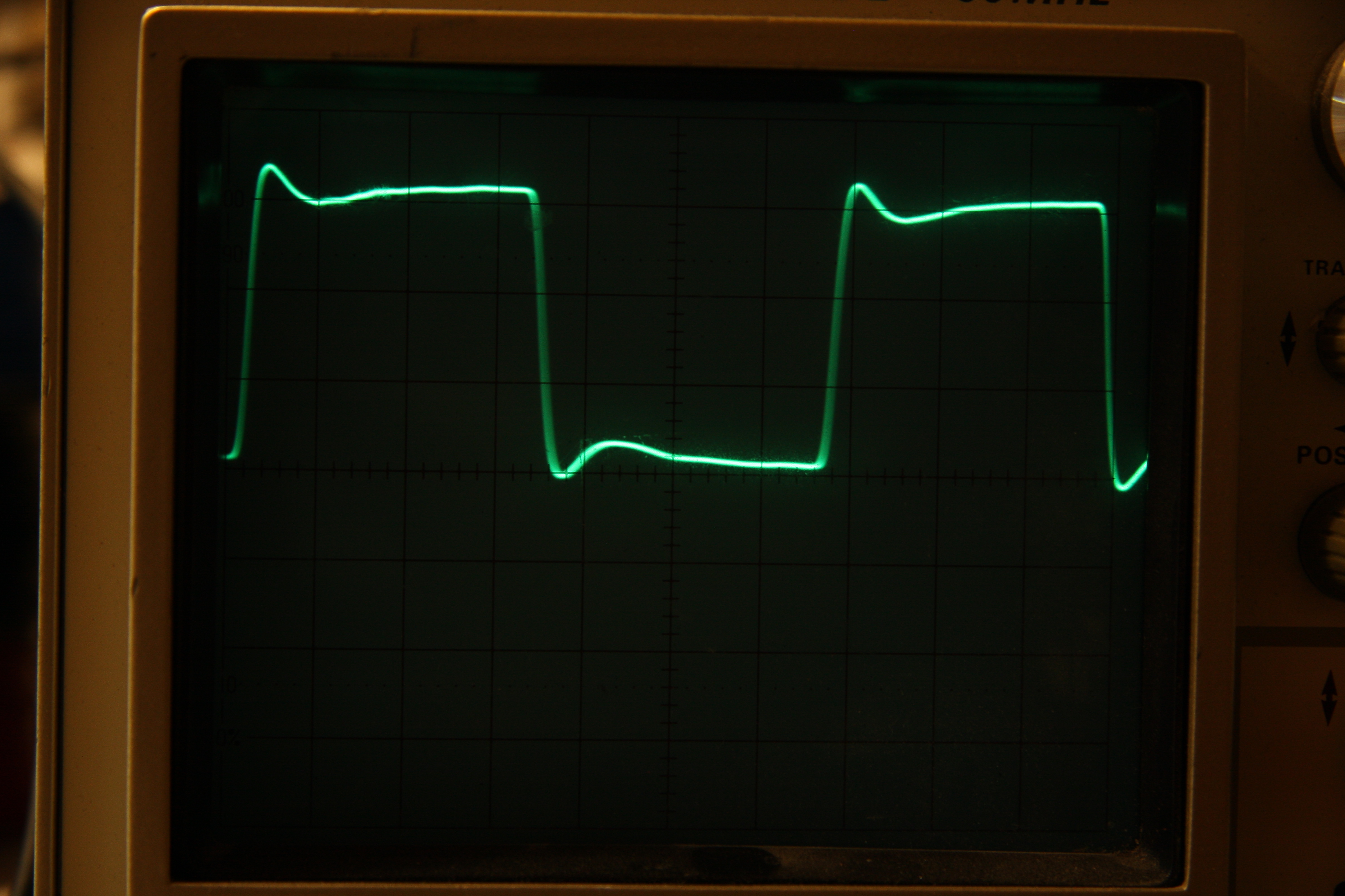

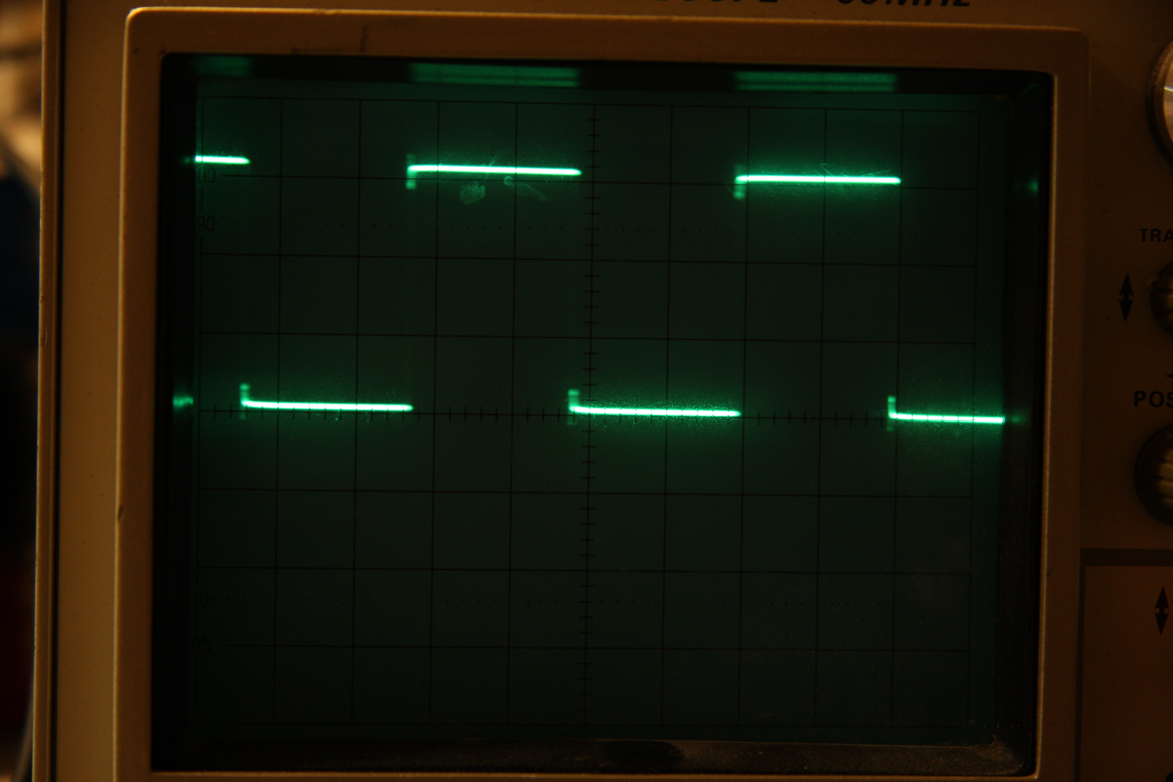

  • Thanks Don.
    I've built up another board and now I get the noise only intermittently, if I turn power off and on again several times it often goes away! Below are the scope shots, one at a time though I'm afraid. Made with 10x setting, inch long ground clip, 60MHz bandwidth scope. Changing the series resistors doesn't noticeably effect the waveform so I'm not sure but I may be reaching the limitations of my probe/scope here. Many thanks.
    MCLK:
    LRCLK:
    BCLK:
    SDATA:
  • The reason I ask for scope shots is to see the 4 I2S signals together and get a sense of the clock rates, as well as where the data is aligned so that I can match it up with the settings. So the above shots at least give me an indication that the clocks are clean looking but none of the other information. You have the part set for normal I2S which is actually right justified, is this what your DSP is set up for?

  • Hi, got the scope working again. Could really do with some help here please.
    (Found it impossible to get edges of all 4 traces showing at the same time, as LRCLK is so much slower than MCLK, maybe one of these new scopes could do it but not mine. Traces are less clean and tidy due to ground clips etc...).
    So, MCLK, BCLK and SDATA when noise is low:
    MCLK, BCLK and SDATA when noise is high:
    Can see a slight change in SDATA, is more visible in the next two.
    BCLK, LRCLK and SDATA when noise is low:
    BCLK, LRCLK and SDATA when noise is high:
    This change in SDATA is consistent, does this imply this excess noise is being sent to the DSP as 'information' as opposed to signal corruption somewhere?

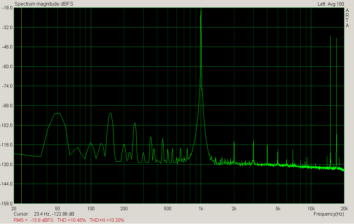

    Changing the ADC from slave to master stops this noise however these 'spurs' crop up. Would imagine the problem is related, do these 'spurs' help with things to look for? With a 1k input signal the spurs are at 15kHz and 17kHz, with a 500Hz input signal, the spurs are at 14.5kHz and 16.5kHz.
    Many thanks.
    If you change the sampling rate when in master mode does this also move the spurs? What is providing the master clock, a PLL or crystal. It would be helpful if you could post the schematic for this portion of the system to get a better idea of the inputs and outputs. Are you able to hook up the outputs to a know good I2S receiver such as an audio tester?
    Justin
  • Ah! Silly me, I was changing from slave to master but not changing the oversampling configuration pins, with those set appropriately the spurs disappear.
