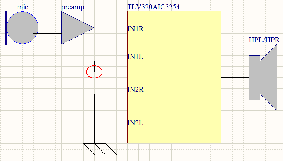

I'm still working with the TLV320AIC3254 on a similar project,but I gave up the inverted inputs issue (original topic).

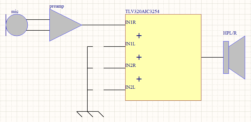

Indeed, I decided to use a single better microphone on only one input, avoiding the sum/difference issue. However, to have a quick overview, I first didn't modify the PF (you can read the config on the original topic) just to check if the new micro+amplifier were correct. They work ! But during these quick tests, I noticed a weird behaviour of my inputs and I would like to get your opinion/solution about it.
I plugged my preamp on IN1R and grounded the 3 other inputs. As the original program summed them all together (summed the 2 differential pairs, which were in fact the difference of 2 opposite signals each... anyway), I was supposed to get IN1R+IN1L+IN2R+IN2L on my output (HPR/L), and as inputs were all grounded except IN1R, I just was supposed to get IN1R+0+0+0. Right ?
Definitly not ! I got a weird silent output which cracks (like over clipping) when the sound becomes too loud or when blowing on the mic. I first thought about grounding issue or instability... But as this mic signal is used elsewhere on the board, I knew the signal was good and the ground didn't have such a huge weakness... And I finally found that when the 3 others input pins where let unplugged, my ouput was good as IN1R. Why !?
Why do you think grounding inputs can involve such a weird behaviour whereas letting them unplugged gives me the normal signal ?
Cheers !
  • I made a few other tests and the weird stuff is still there, but only concerns one input pin.
    First of all, here is a better synthetic view of the program in the codec:
    And this is what I found : I can ground one (doesn't matter which one) or both pins of the second pair, it works. However, grounding the second pin of the mic pair makes it not working. Weird isn't it ?
    Do you understand the behaviour of the codec inputs ?
    Just as a recall here is my codec setting:

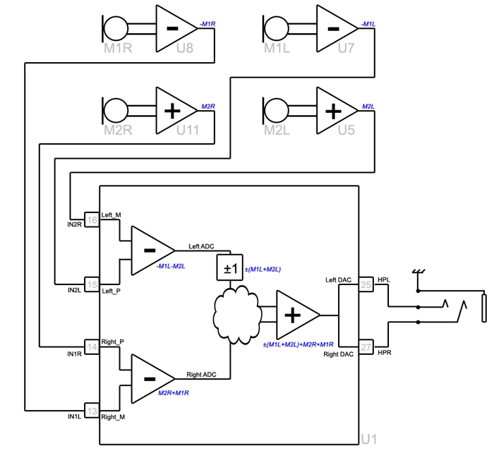

  • HI Maxime,
    If you configure the inputs as differential it will subtract + and - terminals including the DC component. For this reason, you cannot connect one of the pins directly to ground because this will create a huge DC offset at the ADC output. You always need to couple the input with a capacitor (as explained in pages 13 and 14 of this app note www.ti.com/.../slaa404).
    If you connect in single-ended mode, the M terminal of the MicPGA must be connected to CM. For example, if you connect two inputs to MicPGA_P using internal 10k-ohm resistors for each, then you need to connect the internal CM1x (10k) and CM2x (10k) to MicPGA_M.
    For differential mode, there is no need to connect CM to the MicPGA_M.
    Single Ended Example (must be AC-coupled with a capacitor):

    => reg[ 1][ 51] = 0x40 ; Mic Bias enabled, Source = Avdd, 1.25V
    Anyway, I'll use your advice with single-ended mode. In my case, I only have one single-ended mono input on IN1R so : IN1R > 10KO > MicPGARP and CM1R > 10KO > MICPGARM. Is it enough ? What should I do with other pins to avoid similar issues ?
    For better understanding, see my new schematics (forgive the miss of pull-down resistor on jack mic pin,it's a WIP), there is a coupling cap. Just imagine that this schematics comes up with the previous  block diagram regarding the codec's program with 3 other inputs grounded:
  • I just found something about  floating inputs in p1-reg58 (don't know what "weak" means in this case).
    Do you think I should use it to kill my not used inputs ?

  • The weak setting basically pulls the input to common mode (0.9V or 0.75V) even if the input stage is powered off. This is to reduce pop.
  • The 10k IN1R and 10k to CM connection you mentioned should work ok. Whenever you are not using an input pin, simply don't connect it to MicPGA_P. Whenever you need an input, connect it to MicPGA_P (e.g. 10k resistor) and connect CM with same resistor value to MicPGA_M.
