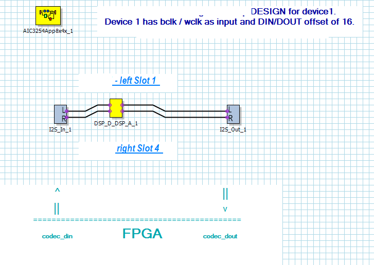

I am trying to run a simple digital loopback in a 3254 codec using DSP_D_DSP_A component in a real design using PPS.
The i2s is multiplexed over 3x3254 devices using i2s mode.
I have already discarded bad 3254 clk configuration as this configuration (clks) works fine in some other tests.
Device0 provides clocks setup for device1 and 2.
PPS design below: nothing magic very simple design:
When I observ with a scope the DIN my design it works exactly as expected (din enters slot1 very cleanly). At dout I have a definitive flat line.
I was expecting the input to be replicated to dout. What's wrong here ? I have tried synchronous mode with no help.

  • Working!
    I am not really sure how useful are the preprocessor directives in the PPS framework setup but I have may be too drastic in removing some..
    For example as I am using a uniq sample rate I removed all those "if" directives and let just appear the internal regs setup...
    ; %%if (%%prop(SampleRate) == 8000) -- removed
    reg[ 0][ 5] = 0x61 ; not used P=6, R=1, J=12
    reg[ 0][ 6] = 0x0c ; not used P=6, R=1, J=12
    OK Solved anyway.
