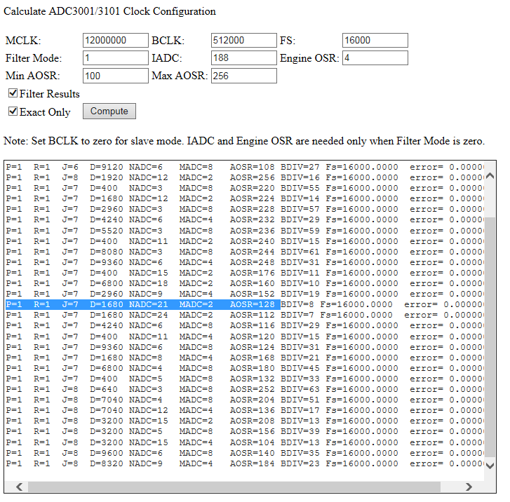

Using TLV320ADC3101 but has problem on 12MHz master clock using.
Main issue is MIC has max volume without any sound input.
I summarized issue in attached PPT file so please refer attached. (Attached also record waveform and other data)
TLV320ADC3101_2Mic ISSUE.pptx
I tested all the PLL setup.
Calculate ADC3001/3101 Clock Configuration(BCLK 521kHz, 1.024Mhz, 2.048Mhz)
MCLK : 12Mhz(Input)
BCLK : 512Khz(Output)
WCLK : 16Khz(Output)
1. Is the unit operable by means of a 12Mhz MCLK input?
- BCLK : 512Khz(Output), WCLK : 16Khz(Output), 16bit data rate, 2 Mic(stereo)
2. If possible, can you find my problem in my setup?
