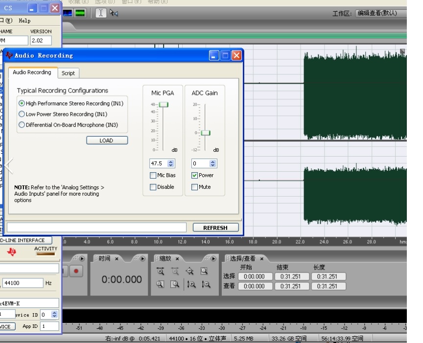

  • Hi Luis:
    We do the test with AIC3204EVM and it's GUI, using the  recording setting recommended by the GUI, just change MIC PGA Gain and Mic input channel. The IIS is analyzed by PC software, such as Audition or Goldwave.
    1, We use IN1 as Mic input channnel. When set the PGA gain to 0dB, DC reference voltage is -48dBV(around 4mV);Then increase PGA gain,The DC reference level move down.When set the PGA gain to the max 47.5dB,the signal reference will be -24dBV(around 0.06V). In this case, customer's algorithm it is difficult to adjust with a indeterminate DC reference voltage.
    2. We change the Mic input channel to IN2, change PGA Gain from 0dB to 47.5 dB, the DC reference voltage just change a little.
    3.We change the Mic input channel to IN3,do the same test, change PGA Gain from 0dB to 47.5 dB,  DC reference voltage is stable, the variation is very very small.

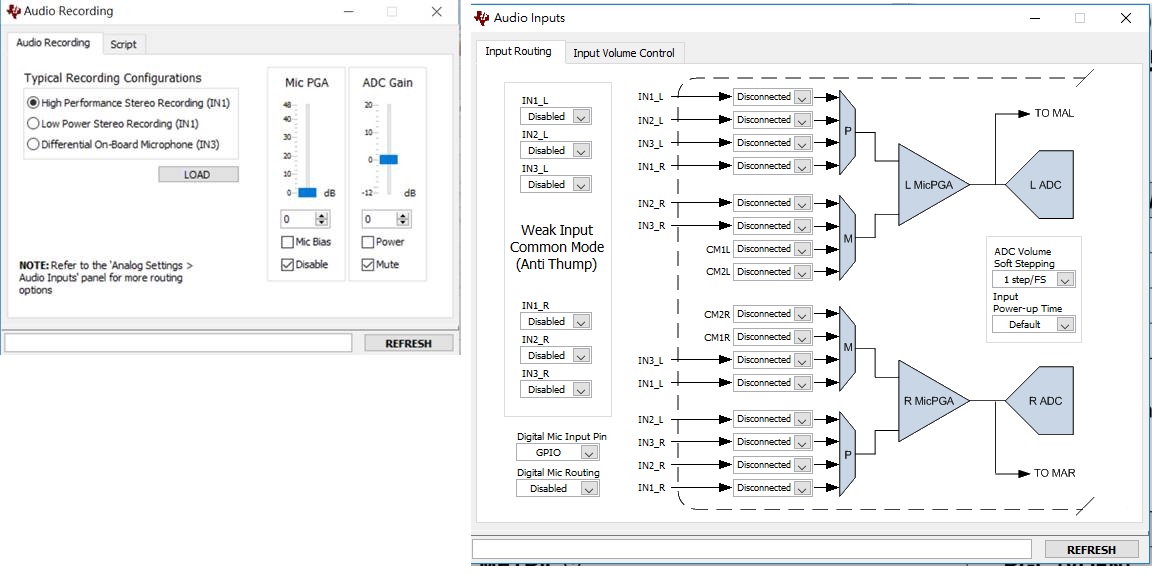

    Use Input routing to change Mic input channel. (IN1/IN2/IN3)
    The offset issues are commonly seen in the audio codecs due to the delta-sigma activity. In order to reduce or eliminate them, I recommend to use the IIR or biquad filters of the AIC3204 processing blocks. The filters may be configured as a high-pass filter at 80Hz. You would only need to configure the filter coefficients to make it. Our TI biquad calculator tool may be used for this purpose:
    www.ti.com/.../COEFFICIENT-CALC
    Luis Fernando Rodríguez S.

  • Dear Luis:
    Add a question:
    The offset issues are commonly seen in delta-sigma ADC, so what caused the different offset performance in different channels?
    As we kown, only IN1 can bypass direct to analog output, is there any relation?
    Best regards!
    You would need to use the coefficients in the respective IIR filter registers. The TIBQ tool will give you three coefficients (N0, N1, D1). These coefficients need to be configured on page 8, registers 24-34 or page 9, registers 32-42. For more details, please consult the First-Order IIR section ( www.ti.com/.../slaa557.pdf ). You would need to use the command-line interface of the GUI to configure the registers by command lines.
    In some cases, the analog inputs have optional or alternative functions that may affect the signal performance. Since the IN1 can be bypassed to the output, it may be affected as you mentioned.
