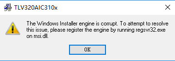

we are promoting AIC3109 in their T-Box. We got a problem to use the GUI of EVM as below, my OS is WIN10. Could you please help? Thanks

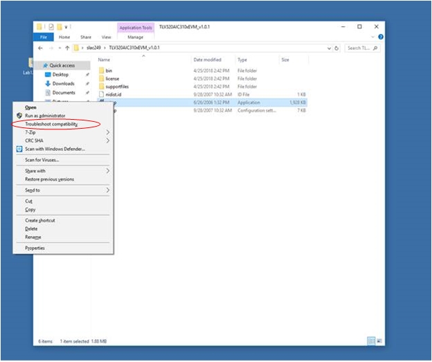

Hello Wayne,
For now please follow the procedure below. we will need to update the GUI installer for windows 10 compatibility. But you should be able to install the GUI now.

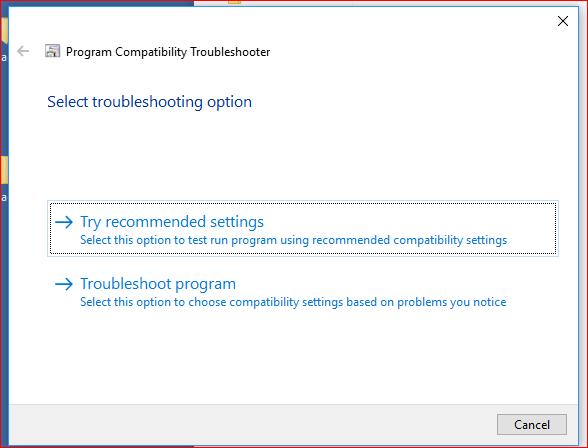

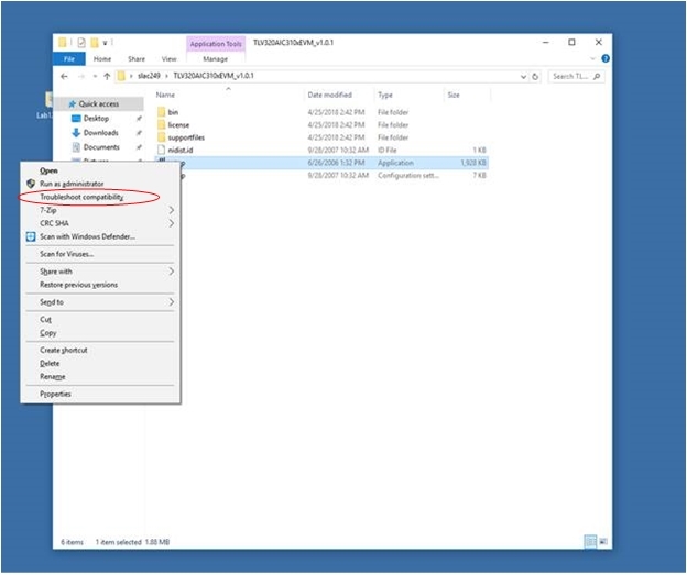

so right click the setup .exe file and click "troubleshoot compatibility"
Then follow the troubleshooting prompts, and at the end. It will ask you if you want to try the recommended settings. choose this option.
You should then be able to install the GUI on windows 10.
