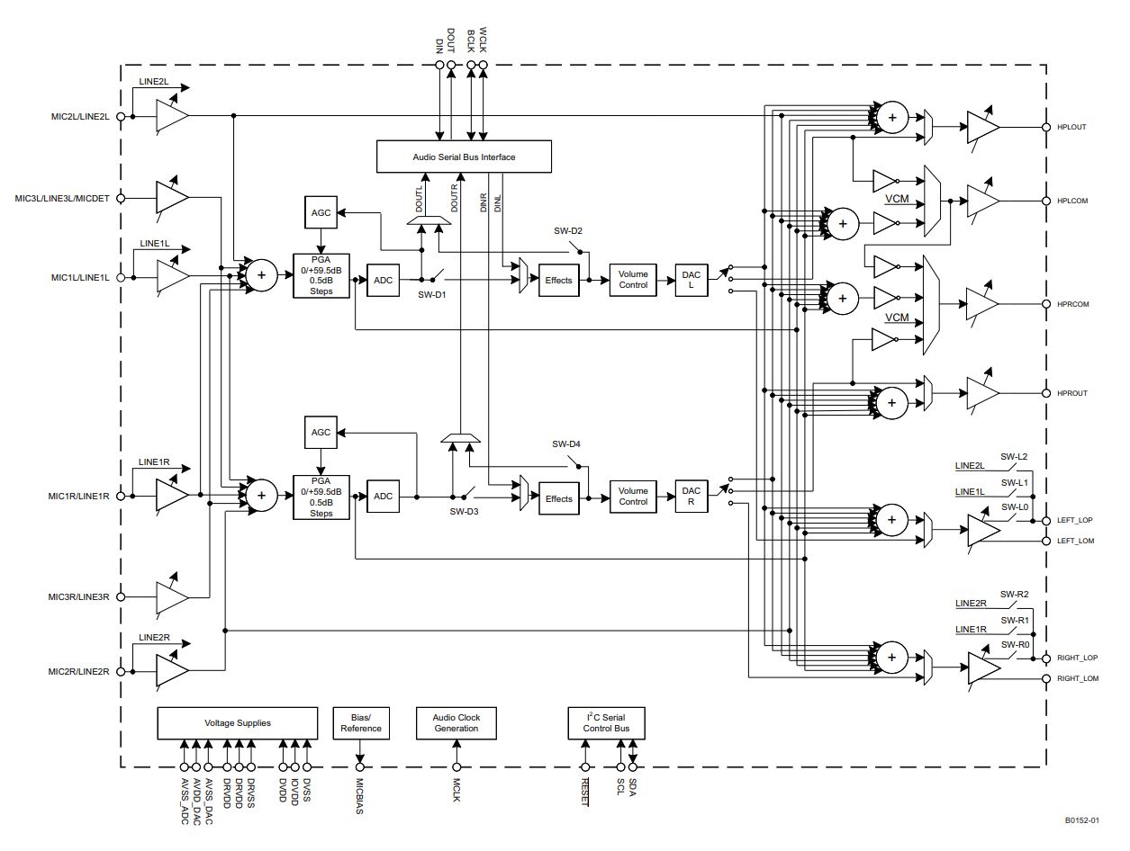

    Im not entirely clear on your 1st question.  the HPL and HPR outputs are headphone outputs,  and microphones can be connected to line1L and line2L.
    regarding routing configurations, there is a block diagram in the datasheet which shows all of the routing.  see below:
    you can also use This driver as a reference. It is far from perfect,  but it might save you some time.

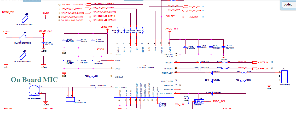

    I have done as below as per the above is this correct??
    gpio-reset = <&gpio5 4 GPIO_ACTIVE_LOW>; ----------------------------------------------------> Is this is correct????????
    Kindly do the needful as early as possible
    Srini

    Could you please answer the below what is the pullup resistors value that needs to be put, ie., what is the value of Rp needs to be mounted as per TLV320AIC3105 datasheet page number 90??
    2. What should be the i2c pullup resistors value for i2c_sda and i2c_scl for 100Khz clock freq. what should be the value whether it should be 4.7k or 10k, does it works with 10k pullup resistors?
    3. Could you please talk to Pavel and help me to get the responses for the same issue whatever I have posted in the above? Am facing similar issue as posted in
    4. Could you please share me reference schematics ie., TLV320AIC3105 interfaced to AM335x, so that I can compare with my custom processor (SAI3 - i.mx6ULL) interfaced to TLV320AIC3105EVM-K board
    5. Also, Could you please let me know how the I2C interface can be verified in TLV320AIC3105EVM-K board using TLV320AIC3105EVM-K evaluation tool??
    Srini

    2: The value of Rp will depend mostly on your requirements.  you can trade off speed and power consumption a little bit. we use 4.7k resistors on the EVM,  but I would advise that you take a look at this application report.  This is a great resource for determining the proper value for your use case.   keep in mind The TLV320AIC3105 can do standard or fast mode,  I don't think it is compatible with fast mode plus.
    3:This thread you linked to is resolved. Try posting in the AM335x forum
    4: I'm not sure I understand what you need here.  all you need to do is connect the reset, I2C, and I2S lines from the codec to your processor.
    5: again I"m not sure what you mean.  The I2C is used to program the EVM. you can read all of the registers that you write to, and verify that they have the proper value. but I'm not sure what other kind of verification you are looking for

  • Srini,
    There are no configurable regulators on the TLV320AIC3105, well.. there is the micbias in register 25... but It doesn't sound like thats what you were asking about.
    best regards,
    -Steve Wilson
  • Thanks Steve,
    Is that BCLK and WCLK is always generated by the codec(ie., is that the codec is always the master for generating the BCLK and WCLK to the processor, or it can accept the BCLK and WCLK generated from the processor, in this case codec acts a slave is my understanding is correct?) ? for ex. how this clocks (ie., MCLK, BCLK and WCLK) are generated with reference to your AM335x and tlv320aic3106?
    May I know, if there is any codec registers where can I verify MCLK, BCLK and WCLK, if codec is capable of generating the MCLK, BCLK and WCLK to the processor and also the registers to read back for which the codec is receiving MCLK, BCLK and WCLK?
    Many Thanks in advance
  • Srini,
    The AIC3105 can be master or slave.  this is set in Register 8 by setting bits D6-D7.  this toggles the  direction of WCLK and BCLK (0= input , 1 = output)
    For future reference, the datasheet for this device is found here.  The datasheet contains a great wealth of information.  please be sure to take a look and let me know if you cant find something in the datasheet.
    best regards,
    -Steve wilson
