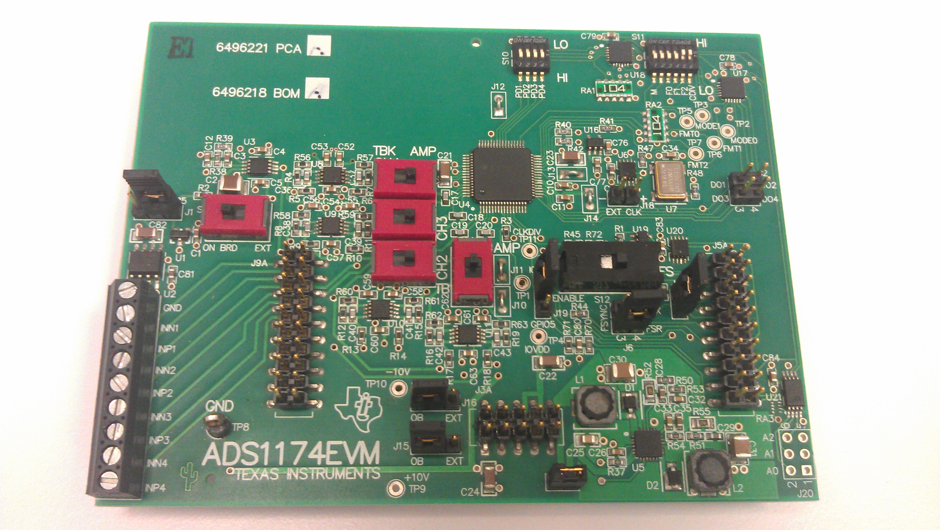

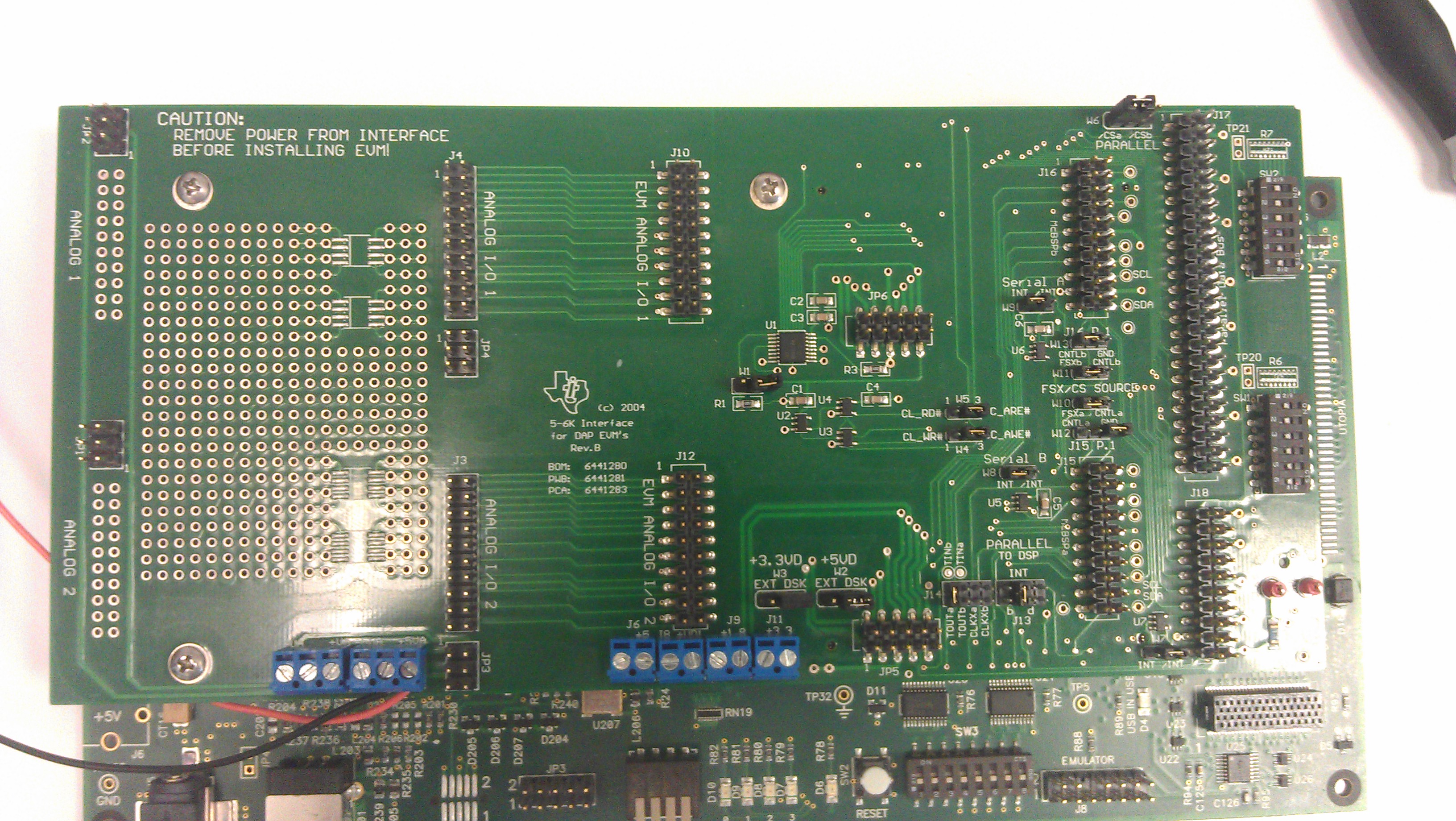

    I have configured everything as stated in the main.c of the project. I attach a couple of photos of the ADS1174evm module and the 5-6K interface card where you can see how the jumpers are set up. After, I changed the McBSP receive register (SPCR) and change RWDLEN1 to 16 bits. Done this, I compiled and run the code. I checked with the osciloscope all the signals. I can only see in J5.3   (CLKX) the clock wich runs at 22 Mhz more or less.
    I have checked all the pins of the adc (directly on the chip) and no signals arrive (no CLK, no FS and no even data). Well the FSYNC/DRDY is at 5V all the time.
    I have a ADS1174EVM-PDK. When connected and used with the MMB0 and the ADCPRO + the plugin, it works and it inputs values. I also checked the signals under this conditions and they arrive correctly to the ads. However, the setup of some jumpers changes (it works with the factory default setting).
    So basically, nothing arrives to the ADS1174. I think that the CLK should arrive even if the project is not running, shouldn´t it?. To start with it is a missconfiguration of the jumpers?. For example J18 only has two pins and in the main.c it says to close pins 1-2. From 2007, did the schematic change? (remember what happened with the DAC8554 that it had been down with a previous version of the board).
    What do you suggest? At this point I am quite lost.
    I attach the images of the boards with the pins so you can see that they are correctly settled.

    * Jumper settings for the 5-6K Interface Board (Rev B): */
    /* W1: open W5: 2-3 */
    /* W2: 2-3 W6: 1-2 */
    /* W3: 2-3 W7: 2-3 */
    /* W4: 2-3 W12: open */
    /* All others: don't care */
    /* J13: INTb J14: don't care */
    /* SW1: All closed */
    /* Power connections on the 5-6K Interface Board: */
    /* J2: +5V */
    /* Settings for the ADS1274 EVM Rev. A */
    /* J1: 1-2 (3125) J16: 1-2 (OB) */
    /* J4: Closed J17: Closed */
    /* J6: 3-4 (FSR-FSYNC) J18: 1-2 */
    /* J15: 1-2 (OB) J19: 1-2 (IOVDD) */
    /* S1: ON BRD (left) */
    /* S2 - S9: AMP (right / up) */
    /* S10: All "OFF" (HI) */
    /* S11: 1-4 "OFF" (LO) */
    /* 5-6 "ON" (HI) */

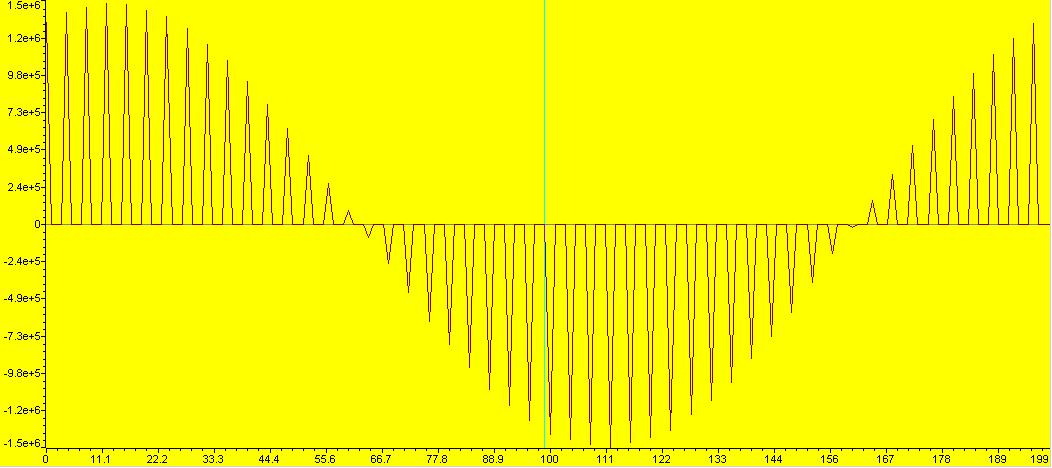

  • The input of INN1 looks like this.
  • Hi Ivan,
    The capture above looks like you have some data interleaved, so it might be plotting data of IN1 with the other channels.  Left click on the graph and change the index to 4.  As for changing from I/O2 to I/O1, look in the DC_CONF.h file.  The serial port setting is defined there.
