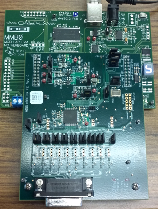

    I've now loaded the software onto my personal 32 bit Windows notebook computer, and I'm getting much further along.  Now I have the dreaded "DSP not ready" error coming up.
    I looked at the schematics, checked and double-checked the settings jumpers, looked in the forums and pondered.  What I have are two stable configurations, see attached photos.  The only difference between the two is that one has ADS1x98ECG-FE JP18 & JP19 set for getting clock source from MMB0 and gives a "5" on the display with the top horizontal segment missing, the other for getting clock source from local oscillator and gives an "8" on the display with the lower right vertical segment missing.
    I've also had JP2 & JP20 changed because I saw a note regarding this in one of the forum postings.  No difference at all.

  • Dean -
    A couple things to check:
    1.  the "8" with missing segment is actually an "e" as is error/invalid setup.  This generally is due to a hardware configuration that conflicts with what the software needs to operate.  While the EVM supports multiple configurations, the EVM software requires the setups allowed in the user guide only (this will be a subset of the overall settings).\
    2.  the "b" missing a segment is the normal startup process...does a second driver (USBStyx) attempt to install once the broken "b" appears? Two drivers need to be installed for the software/hardware to connect.  The first driver should be installed, given that you get the broken "b".  This indicates that the firmware has downloaded to the DSP and the DSP is resetting using the new firmware.  However, at this point the new driver will activate (will need to be installed the first time).
    You can reference the ADCPro document @ http://www.ti.com/lit/pdf/SLAU372  The drivers used are the same, so Section 4 and Figure 10,11, and 18 detail the installation and show the Device Manger screenshots.

  • Further to this... sorry for the extra message, but it just occurred to me.
    The only difference between the two configurations is the positions of JP18 & JP19 on the ADS1x98ECG-FE, changing the source of the clock (on-board oscillator / MMB0 provided).
    This conversation made me want to try this: http://e2e.ti.com/support/data_converters/precision_data_converters/f/73/p/164743/605581.aspx#605581    It shows that I should be using JP18 shorted 2-3 and JP19 shorted 1-2, for External OSC Clock.
    Upon re-read of that conversation, I think my assumption in the previous message was wrong - the "e" code is better, as it avoids the dreaded "DSP not ready... retrying" message.
  • Dean -
    I would say from looking at your pictures that the one with the "b" is the more correct.  Additionally, just so you know, it ("b") isn't an error code and will actually still be displayed when everything connects properly, with the addition of the decimal point.
    For configurations, use the doc @ http://www.ti.com/lit/ug/sbau180/sbau180.pdf.  It is for the ADS1198, but both parts share the same hardware and we are currently updating all this information for the software update.  It should show Table 4, which you can use to verify your default configuration.  This should be the default configuration for the hardware and software to sync.
    A quick note...are you using the included power supply with the EVM?  It looks (in the photos) as though you may be using something else that has a right angle connector.

    • SBAU180 does show JP2 & JP20 for bipolar mode, but I'm using unipolar, so I adjusted for that.
    • JP18 isn't shown in table 4, probably an oversight that you might want to have them correct in the next document revision.
    So other than that, there are the clock internal/external/enable jumpers JP18 & JP19, and I've tried all those already.
    You make a good point about the power supply.  I inherited this PDK from earlier work 6 months ago (I've been here about 5 weeks), and the original power supply is missing.  I'm using a bench supply set to 5.6 Vdc.  The bench supply is all I have at the moment, and it's a homebrew, not sure of its output capacity - although I did look inside and its construction and filtering are good, not clear on the regulator ICs used.  I will chase down a different supply, to see if maybe somehow that is part of the problem.  It could be plausible that this supply doesn't have adequate output capacity, causing the PDK to hiccup.
