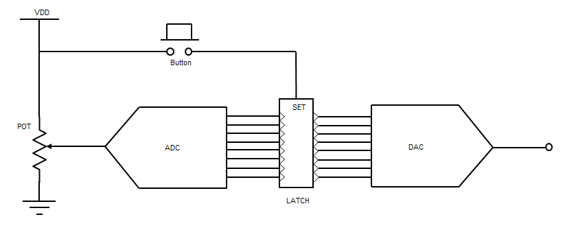

  • It's not a benefit, it's a requirement.  I do want to capture as a digital value and store right away.  Indefinitely.  I do not, incidentally, need access to the data at all.  ADC->DAC.  So it's analog on both sides.
    The sensor is a potentiometer with 3.3v across it.  I need a button that will make an op amp connected to the wiper put out....say...1.85v and hold it there until it's pushed again holding....say 2.4v
    A mickey mouse problem that seems to have no solution short of firmware.  SMH.

  • Hi Joshua,
    I'm in agreement with Kevin's assessment, an integrated solution will probably be your cheapest option, but would require some coding.
    If you wanted to avoid the coding, you could try find some kind of parallel latched ADC/DAC combination, like such:
    I'm not too familiar with any particular devices like this, so I don't have a great recommendation. I did some quick searching and the ADC0804 is the closest ADC I could come by, I didn't come by a suitable DAC.
    Hope that helps!
