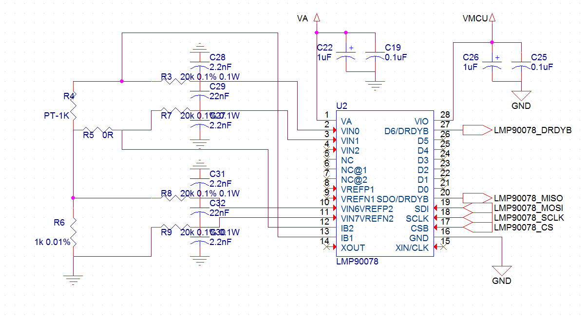

    I've try the sequence with no luck. The is will not pass CRC check. Here is my schematics:

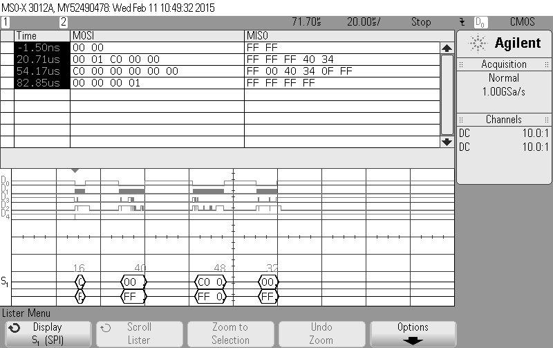

    and here is how it looks on the scope:
    When I comment out the SetPowerDown function, the CRC and the readings are fine.

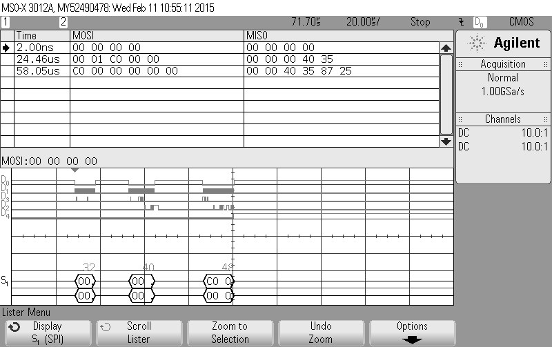

    	 adc_data = 0;

    With 100uA excitation current you are violating the min Vref specs of the LMP90078 as specified in the datasheet at page 8:
    With IB1=IB2=100uA  and Rref = 1k ohm in your configuration:
    Vref = 2 x IB1 x Rref
    Vref = 2 x 100uA x 1k ohm =  0.2V
    So IB1= 100uA with Rref = 1k ohm can't be used in this case. Basically the value of Rref is selected based on the IB setting and the desired VREF voltage.
    To clarify, can you please provide the below information:
    1) What is your desired differential input signal range (according to the full scale temp range in your application using the PT-100)?
    2) What is your gain setting? The maximum allowable PGA gain setting is based on the reference voltage, the RTD resistance change, and the excitation current (please see chapter 3.1.3 of TIPD120)
    3) Also, it seems that you have a mismatch in your input and Reference Low-Pass Filters. C29 must be 10 times bigger than C28 as well as C32 which must be 10 times bigger than C31. In your configuration these are swapped! Please see chapter 3.2.2 of TIPD120  and also here)
    These app notes are based on the ADS127x family devices but can be also be used for the LMP90xxx family devices.
    Mo.

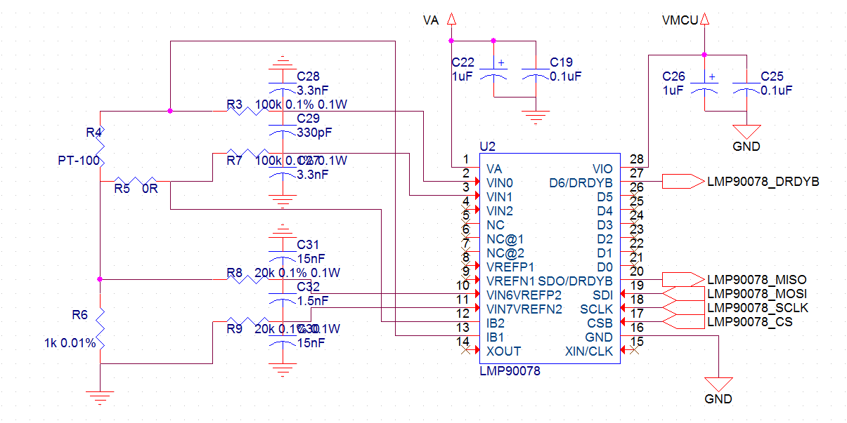

    You are right, I did get it backwards.

    I reviewed my filter design and it according to your recommendations and it fixed the problem.
    As you see I'm using PT-1K and not PT-100, my sampling rate is 13.42SPS and I've choose 150Hz as my -3dB cutting frequency.
    My Rrtd is 1K. I will later change Rref to 820 and redo the filter.
