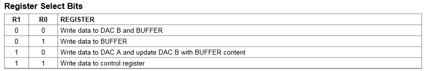

  • Michael,
    I have not worked with this DAC in specific, but I have worked with very similar devices.
    So in this scenario, you want to:
    • Use Fast-mode
    • DAC A data = 0x100
    • DAC B data = 0x200
    In order to do this, you would have to take a look at the Register Select Bits, in page 11 of the TLV5637 datasheet.
    First you would write the DAC B data to BUFFER (R1 R2 = 01). Then you would Write data to DAC A and update DAC B with BUFFER content (R1 R2 = 10).
    It would look like this:
    1. 0x5200
    2. 0xC100
    You can repeat this over and over, while changing the DAC data that you are writing every time.
    Hopefully this is clear enough, this is a very old device and the interface can be a little tricky sometimes. If you still have any questions please do let me know.

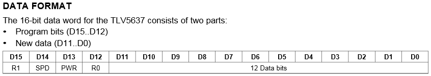

  • Hi again
    Thanks for so prompt answers :) But I dont really get it. First you say R1 R2, but we only have R0 R1? Is R2 R1 and R1 R0?
    Second DAC A data = 0x100, this is a 10 bit dac with the 10 bits arranged D11-D2!
    So could you help me abit more ?
    Apologies. It is as you say. I meant R1 R0.
    1. First using R1R0 = 01, to store the desired DAC B data into BUFFER.
    2. Then using R1R0 = 10, to update DAC B, and write new data to DAC A.
    I used 0x100, because there are 12 new data bits in the SPI interface. Where the left most 10-bits are real data and the right most 2-bits are always zeroes. This means that the maximum possible code is 0xFFC or 1111 1111 1100.
    I hope I cleared the confusion here.

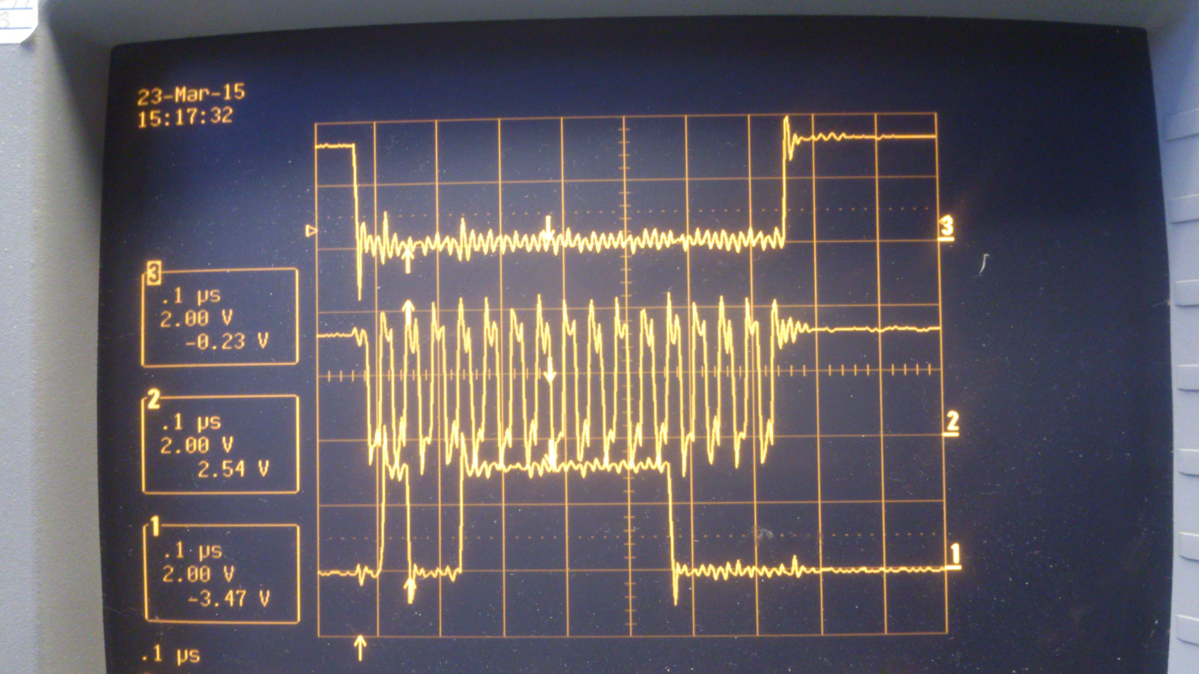

  •  Hi I hope that you are still with me, something came up last week.
    Please see my screendump abouve. CH1 is data, CH 2 is SPI clock and CH3 is SPI CS
    cheers
    Michael
  • Michael,
    Thank you for sharing this information with me.
    It looks like you are sending 0x4FF0. This would update CH-B to a voltage value close to the reference, but it is not working for you the first time that you send it to the device. Can you confirm that the plot that you send is this specific case?
    Some of the spikes on the falling edge of SCLK line look fairly close the 0.6V threshold (page 3 of the datasheet). They might be causing false SCLK edges. If you are able to provide a cleaner digital signal it might be a good idea to try it. I am going to have to test this in the lab. I am out on a business trip the rest of this week so I will not have access to the lab until sometime next week.
