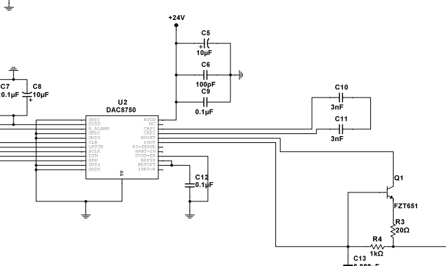

    I have selected DAC8750 for the application. I have control current 4-20mA based on data sent over SPI
    1. I have attached the circuit.
    2. I have left R3-sense open. Is it right?
    3. Similarly I have left open Hart-In & Iset-R open, since i am not using hart protocol. is it right?
    4. I will not slew rate feature. So is it ok to left open cap1 & cap2 pin,  or some capacitor value is recommended. If yes, what should be default value?
    5. Any other comment on circuit.

  • Vindhyachal,
    This is fine. If you'd like to avoid leaving some of these nodes floating, you can AC couple HART-IN and R3-SENSE to GND but this is not required.
    It is okay to leave these nodes floating. When these capacitors are in use, though, they should be in series between the CAP1 or CAP2 pin and AVDD. Right now your schematic has CAP1 in series with two capacitors back to CAP2.
  • Hi Kevin,
    I have attached the updated circuit.
    1. I have decoupled R3-sense & Hart-in pin with 0.022uF as shown. Is it correct?
    2. "When these capacitors are in use, though, they should be in series between the CAP1 or CAP2 pin and AVDD. Right now your schematic has CAP1 in series with two capacitors back to CAP2"
    I didn't get what u are saying here. Can you show some example.
    I have taken the reference from circuit in SBAU205A (page 21) , it has capacitor connections on CAP1 & CAP2 pin as I have done.
    Edit: 3. Is it ok to leave ISET-R pin floating?
    Sorry - I miss-spoke (or miss-typed, as it were) what I meant to say here. I meant to suggest AC coupling HART-IN and ISET-R, not R3-SENSE. It's still okay to short R3-SENSE but it's not really as relevant as it would be to do it to the other pins, I would suggest you just leave R3-SENSE floating.
    The new schematic is correct.
    As I mentioned above, you could AC couple this pin to GND if you'd like or leave it floating.
  • Hi Kevin,
    Thanks for reply.One confusion remains, otherwise its ok.
    In Post#4 you have said that
    "It is okay to leave these nodes floating. When these capacitors are in use, though, they should be in series between the CAP1 or CAP2 pin and AVDD. Right now your schematic has CAP1 in series with two capacitors back to CAP2."
    while in post#6 you said
    "The new schematic is correct."
    However I didn't made any changes in cap1 & cap2 capacitors connections.
    For clarity sake, I have attached same schematic with below changes:
    1. Iset-R & Hart-in are decoupled by 0.022uF cap each.
    2. R3-sense is left floating.
    3. A 3nF capacitor to each Cap1 & cap2 pin with second connection to ADVDD.
    Design1.pdf
  • Vindhyachal,
    I'm not sure what happened with your original schematic, maybe the PDF was corrupt. Here is what I saw:
    In any case, what you have now looks good.
