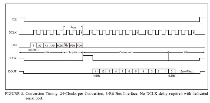

How do i give the Din input to ADS7841 to start the ADC? I am basically testing the ADC chip in product engineering lab
  • Hello Sameers,
    Figure (3) on p10 shows one typical way to trigger conversion on the device using 24 CLKs per conversion.  The first eight clock cycles are for the command byte.   After this, the device enters conversion mode.  The next 12 clocks perform the conversion, and the LSB is read on the 13th clock after the command byte.    The control bits in the control byte (to select channel and mode of operation) are defined on page 11.   Table VI and VII define the required timing.   Please let me know if you have questions.

  • Hi Luis,
    Thank you for the inputs. I just have the ADS7841 chip with me which I am testing. What hardware do I use to give the trigger and the control byte to the Din pin so that the ADC works.
    Thanks for your patience
    Sameera
  • Hello Sameera,
    You will need to interface the ADC with a controller (i.e. DSP TMS320Cxxxx processor, MSP430 microcontroller,etc) or a digital I/O card of your choice.  Unfortunately, the ADS7841 is an older device; and there is no kit available that you can readily interface with your PC.
