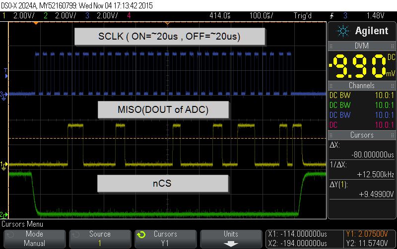

    below is snapshot of the SPI interface
    but still i often encounter that the ADC is Stuck (e.g. nCS goes low while MISO is HIGH) , even if try to query several times  the MISO(DOUT of ADC) Stay High
    while the nCS is low , the interval between queries is ~ 100ms , Any idea ?

  • Eyal,
    Thank you for your follow up.
    I am suspecting that the part is getting reset somehow and is out of continuous conversion mode when the issue happens. The default state of the part is single-shot mode. Can you only read the Config Register when this issue happens? You could keep the DIN low for the first 16-bits of the 32-bit transmission cycle to avoid writing to the Config Register and the next 16-bits should give you the Config Register readback value. If you do so, do you still readback 0x4262h?

  • Eyal,
    Can you try to extend out your time from when /CS goes low to when you clock out your first SCLK? You may also need to extend the time from the last SCLK to when /CS returns high again. It looks like your SCLK takes to long to transition going on and off and vice versa.
    Joseph Wu
  • Eyal,
    Sorry, I meant /CS is taking too long.
    Joseph Wu

  • Hi Krunal ,
    I think i understand the scenario that causing this issue , i have succeed to view it on scope (unfortunately i don't have screenshot) .
    when this issue happens , after nCS goes to low the DOUT of ADC (MISO) is also low , but after ~20us it goes high for ~30us and than returns to low again.
    to solve this issue i add logic that check the DOUT after nCS goes LOW , and if DOUT is HIGH wait for ~30us , only then i preformed transmission cycle.
    what do think about this phenomenal ? is it normal behavior of the ADC ?
