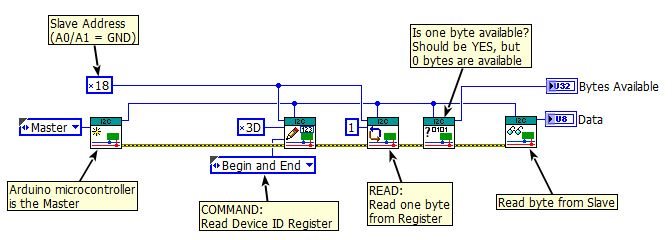

I have grounded address lines A0/A1 and hence I'm sending the 8-bit Slave address of 0x18 from my microcontroller to the AMC6821 chip.  On a CRO I can see the pulses on the SCLK and SDA lines so I know I'm clocking data in and out.
However whenever I try to read a byte from any of the registers (following Table 7 format in datasheet) they are always returning 0xFF.
At the very least for Device ID Register (address=0x3D) I should read a default value of 0x21 and the Company ID Register (address=0x3E) should read a default value of 0x49.  These are read-only registers so there is no way I could have accidentally overwritten them.
Is the IC faulty or something, or am I doing something wrong in using the i2c bus?  I have attached the circuit diagram below.

    Yes I have pull-up resistors on the I2C bus and I know that they are working, because I have other I2C devices on the same bus working correctly and I can also see data on the SCLK and SDA lines from a CRO.
    I am using the same basic i2c code I used on a MAX7318 i2c chip on the same board (which works), which is written in LabVIEW (same language you use for your AMC6821EVM Evaluation board - is this available for download?).
    The Master (microcontroller) sends the 8-bit register command for the Device ID Register (0x3D) and I then try to read one byte from this register (it should be the default value of 0x21), but it says there are no bytes available.

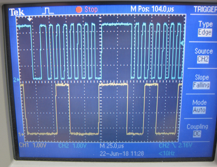

  • Hi Chris,
    Another item that would benefit the debug of you communication is to share an oscilloscope capture of the I2C transaction. Can you provide the readable I2C frame?
    Matt
  • Hi Matt,
    The attached CRO images is of me sending the Slave Address 0x18 and then the Command Register Address 0x3D (Device ID Register).  In my software I then also send the Slave Address again and the command to read this Register Byte.  However you don't see that on the CRO, because the first send receives a NACK indicating (I assume) that the AMC6821 didn't respond to this command.
  • We felt the temperature of the IC and it was 44c which was hot to touch - so we thought it might have been faulty.
    We replaced the IC and it immediately started to work as expected.
    I guess we were just unlucky :-(
