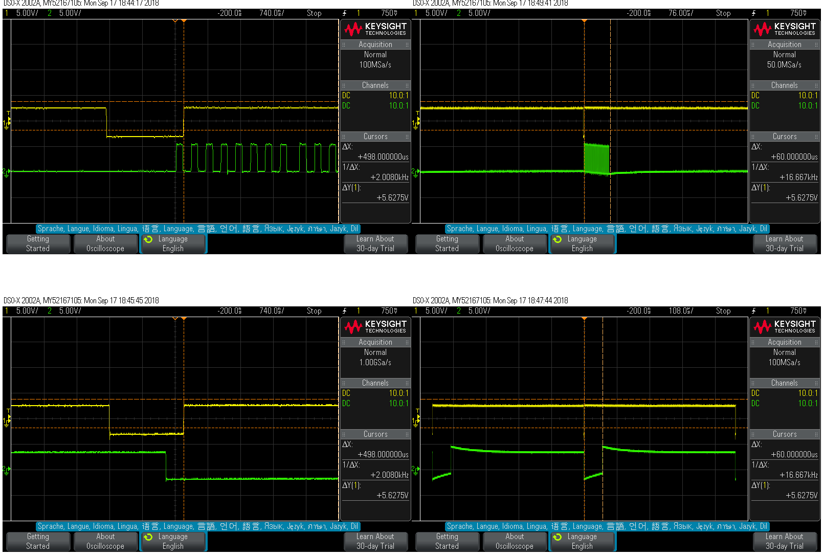

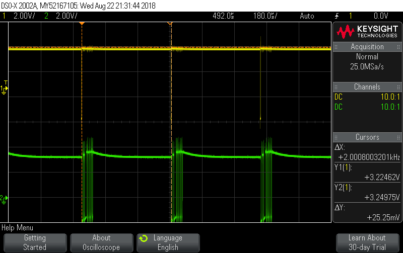

    The yello is the DRDY Pin, the green ist the spi read. it look ok.
    I used 50HZ Signalgenerator to test the channels.
    In the meantime I discovered the problem is only with channel 1,2, and3! Channel 5 and Channel 6 are ok

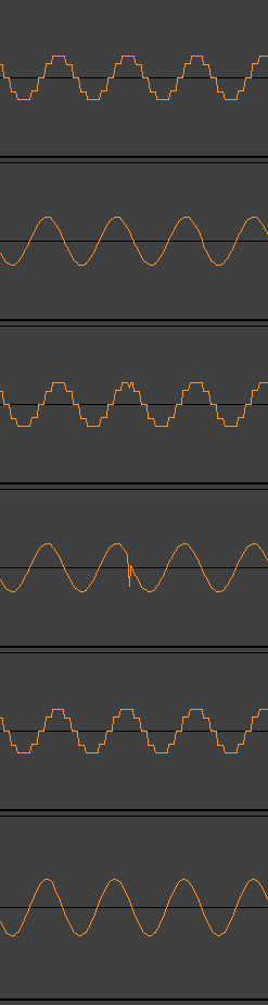

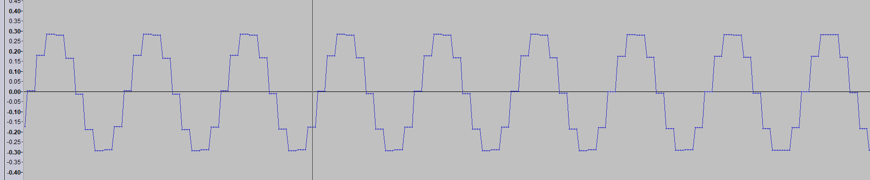

    I'm still not understanding what exactly the issue is, are you referring to the "steps" that I'm seeing in your waveform?
    What is your input signal and PGA gain?
  •  Hello Alex
    Yes this steps are the problem, I use for all the 6 channel the same Gain (gain=1). On the analog input I connect a signalgenerator with 1Volt and 50Hz.So all the channel have the same signal. My sourcecode read all the channel in one go in a loop.So you can see the Channel1 (on top) is bad. Channel2 is ok, Channel3 bad ....

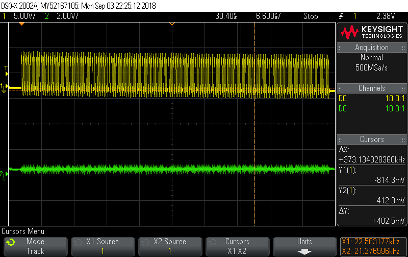

     On the second picture
    I sweep the frequence
    from the analoggenerator
    and it looks as if channel1,3,5,7 can not sample higher frequencies.

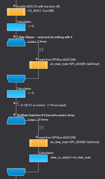

    Can you post your code showing how the output codes are being converted? I still think that this looks like a data corruption issue.
  • Hi Alex
    Sorry the 21*8 means 21*8bit, 3*8bit staus and 6*3*8bit data.
    For the sourccode I used Flowcode 8 from Matrix.
    (Flowcode is an advanced integrated development environment (IDE) for electronic and electromechanical system development targeting microcontrollers such as Arduino, PIC and ARM)
    In the interrupt I read the 3 status register Byte and to nothing with them....
    and the 18 Byte from the channel I put first an array and then in a buffer. This buffer I flush to a micro-sd card.

  • Hi Alex
    In the meantime I have tested 3 different boards and always the same problem.
    I have attached to the 3 channels 2,4,6 electrodes and made a record. This record was good. I would like to use this IC already.
    Yes at first it was different with the channel.But I'm not 100 percent sure
    After I made my software more stabel and more comfortable to show the channel nicely
    it is always Channel 1,3,5 bad  and Channel 2,4,6 good

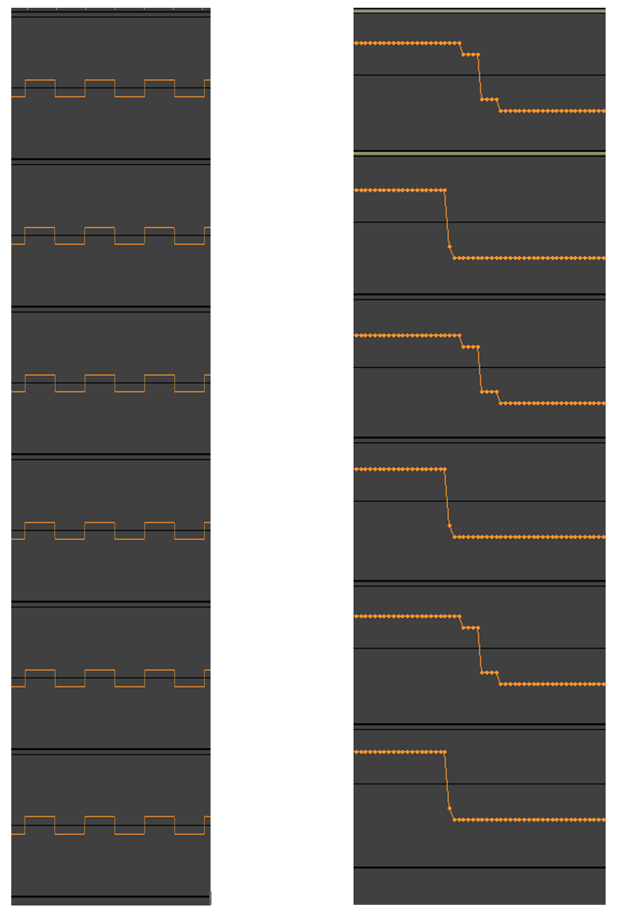

  •  Hi Alex
    I tried with the intern testsignal.
    At the picture left is normal view.
    At the picture right is zoom view.
    This looks not good for channel 1,3,5
    4 times the same value....

  • Hi Stefan,
    In your code, are you discarding bits at any point?
    I see a note that says "7-8 bits not used"
    If these bits are somehow being thrown away it would explain why you're seeing the repeated outputs.
    Also, keep lead off detection disabled for now.

    You can see:
    at first left yellow=Interrupt; green=clock; at right side in an another timebase
    at second  left yellow=Interrupt; green=chipselect; at right side in an another timebase.
    I think the signals are correct but half of the channels are not ok.

  • Hi Stefan,
    I did not realize from the code comments that that was in regards to channels 7 and 8. However I think you should take a long look at your code and investigate to see if this is related to the problem. There is most likely an error in your loop at some point that is resulting in bits being discarded, and the output code being repeated.

    This issue is due to data being transferred incorrectly. There is an issue with either codes being incorrectly discarded, codes being repeated, improper addresses, etc... any of these could explain why the data is being corrupted in between the device and the output waveform.

  • Stefan,
    I do not think any positive results will come from testing like this.
    There is an issue in your code that needs to be fixed.
    The ADS1299 is not getting confused or crashing.
