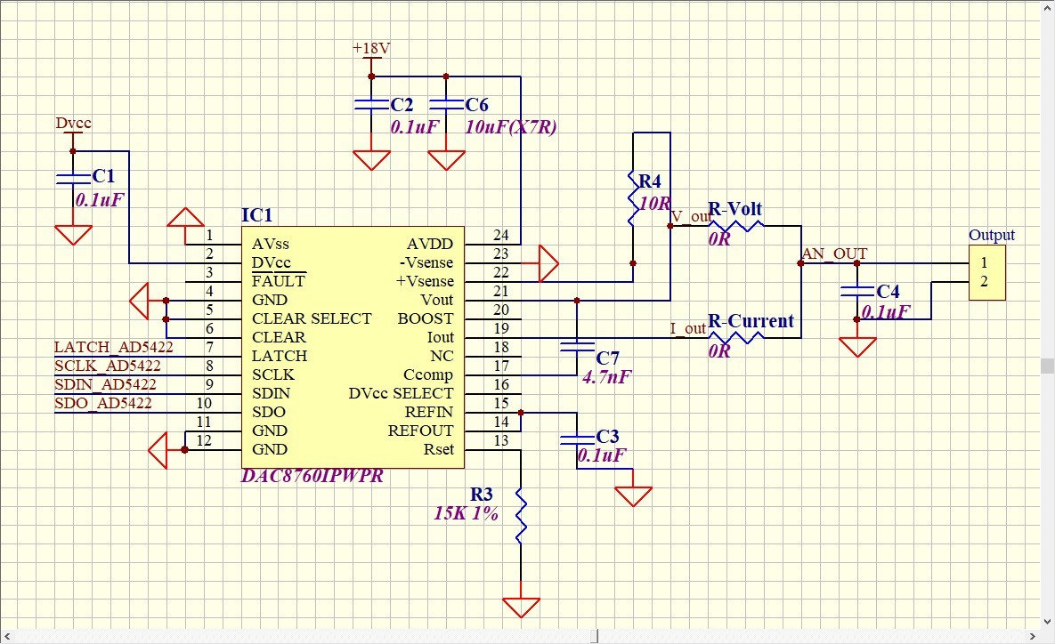

    Could you share a schematic at least covering all adjacent circuits for the DAC8760?

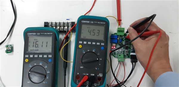

  • Thank you, Kevin. This is my circuit. R-Volt and R-Current are select output type.

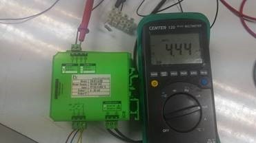

    In this case i assembly only R-current. First I use DMM measure a mA output on terminal output with out load, current output is 13.03 mA, Next I do it again with load 500 ohm, current output is 4.44 mA. please see picture below.
    Measure With out load
    Measure with load 500 ohm.
    Thank you.

  • Hi Kevin. Thanks you for you post.

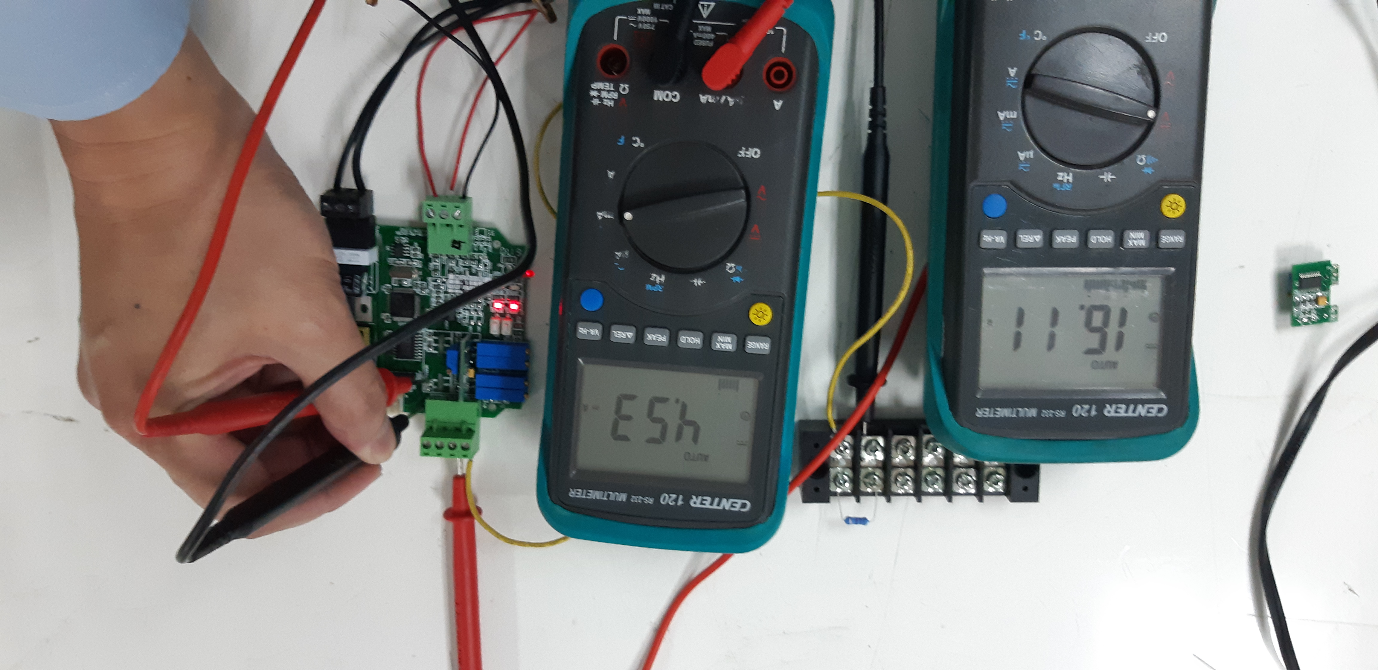

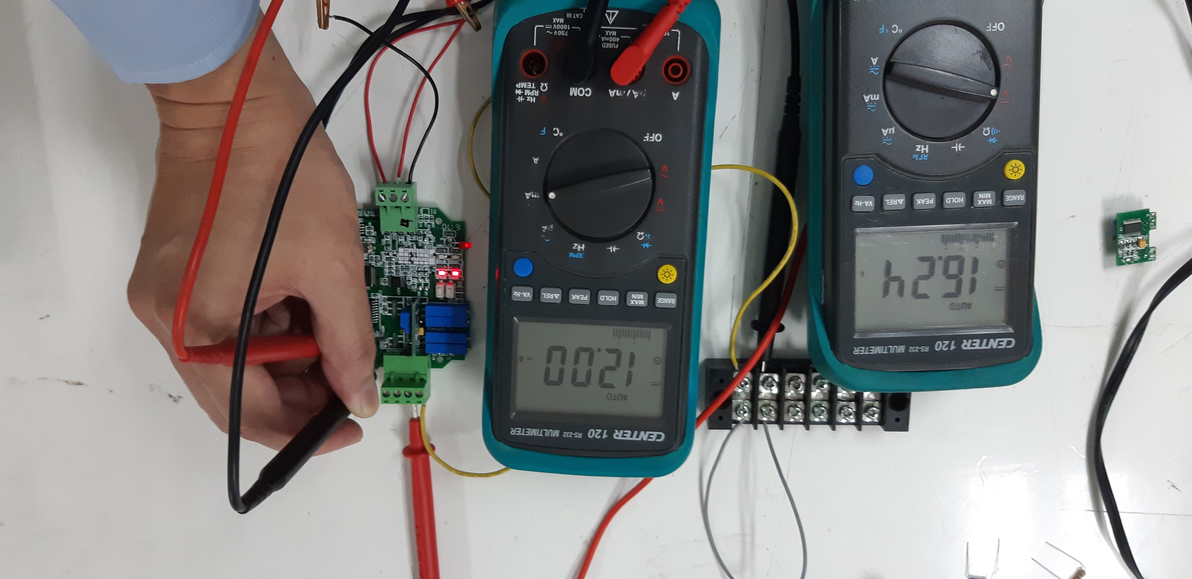

    The Voltage apply to +18V rail is 16.11 to 16.28Vdc. I have two testing, first is a result of the damage module, and the second is result of the new module that replace the damage module on the same controller board.   Please see a picture below.
    The damage module, an expect output is 12 mA, measured output with no load is 12 mA, and Avdd is 16.24 vdc.
    The damage module, an expect output is 12 mA, measured output with load 500 ohm is 4.53 mA, and Avdd is 16.11 vdc.

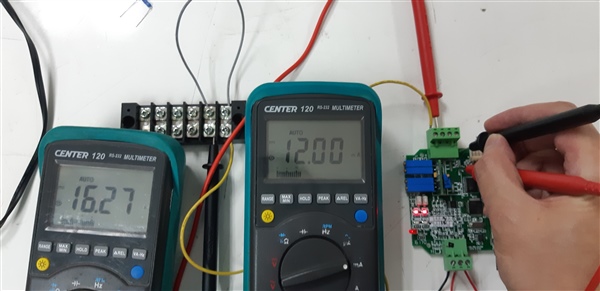

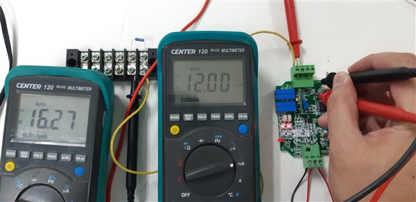

    After testing the damage module, I replace it with a new module and the result show below.
    The new module, an expect output is 12 mA, measured output with no load is 12.00 mA, and Avdd is 16.27 vdc.
    The new module, an expect output is 12 mA, measured output with load 500 ohm is 12.00 mA, and Avdd is 16.27 vdc.
    I think the DAC8760 on first module is damage. Is it correct?
    In fact, I try to know a situation that why it is damage?, how this problem can happen? So I apply a wrong signal as 24 Vdc to output pin of DAC8760, but it still ok after apply 24V for hours. I don’t have any ideas for this. How to prevent this problem? If you have any ideas please let me know. Thanks you Kevin
