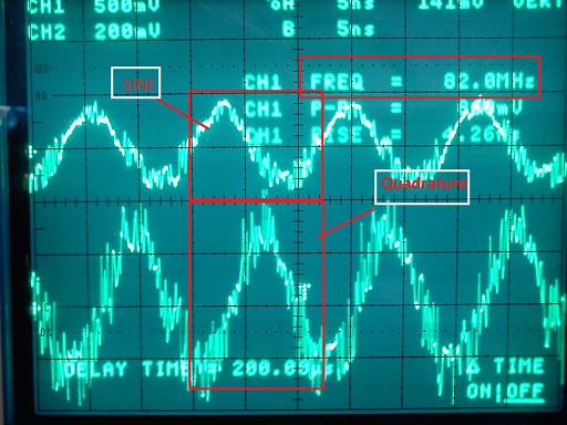

  • Hello again, the information you gave us was very helpful to get us going in the right direction. We also realized that we had used the wrong pins for the data since the pin change from dac>>fmc>>fpga was a little confusing. We believe we finally got the right data pins and possibly the clock synchronized, however we have a problem because we are gettting a wierd sine. The first half has an arch down and the second an arch up, pretty much both with the peak pointing to each other.
    We have attached a picture of the result. We did some reasearch and it might be the signed or unsigned numbers from the DDS in the FPGA. The data we produce from the DDS is coming out signed and we are not sure if the DAC is made to receive signed or unsigned, and/or if it has a jumper setting that might allow either of the two.
    We are working on a solution to unsign the numbers and test the DAC but wanted to get your input to see if we are on the right track as we are a couple weeks from the deadline for the project. Your help is very appreciated and here is the picture of what we obtained when sending signed data to the DAC.

  • Manuel,
    I agree with you, this does look like a 2's compliment vs. offset binary problem. The DAC3162 needs an offset binary input, it cannot be programmed to accept 2's compliment.
    I believe you can just apply an XOR function on the MSB (XOR the MSB with a constant 1).

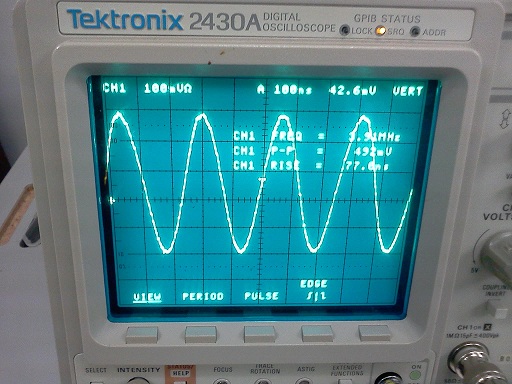

  • Hi, your advice has been very useful. It was what you pointed out, the DAC is taking offset binary and we were sending 2's complement  binary. Reading a little more we found out one can change 2's complement to offset binary simply by changing the MSB into the opposite value like you told us. We tried it using a inverter and also an xor gate and both worked.
    The only problem we have now is that the cleanest wave we can achieve is at about 30MHZ after that the wave starts getting some distortion and can go up to maybe 60MHZ without looking completely different but not good enough in terms of a signal to be transmitted. Reading more on sampling theory i see that every cycle has to have at least 2 samples accoridng to nyquist but that will not give us a good enough wave, we have tried using  5 or 6 samples and that would give Fout of about 100 to 83 MHZ.
    My question now would be in your opinion can the DAC get to these frequencies and produce a decent enough sine wave for transmittal (through coaxial cable). We are unsure completely if we are simply having timing issues with the data or if its only because of the number of samples, and maybe rise & fall time, of the DAC are causing this distortion.
    We saw in the documentation that from spectrum analysis for the DAC3162 datasheet.pdf that they only test 10MHZ and 70MHZ, however we can't see any samples of any wave produced and we are at a loss if the extra sidebands and noise on the 70MHZ comparison would cause such great distortion.

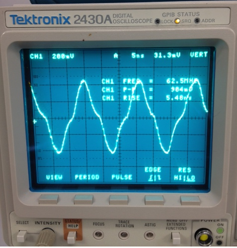

    Below are the first pictures we took; one is at ~4MHZ and the second is at ~ 82MHZ. I will post newer ones later on since there's been some design changes which made it look good up to 30MHZ. Thanks for the help again.
  • Sorry the ~4mhz picture did not upload. Here it is and the newer one as well:
    With some changes to the design picture at ~63 MHZ
  • Manuel,
    The DAC3162 should be able to produce a cleaner sinewave than what you're seeing. Most of my experience with DACs is using a spectrum analyzer to look at the frequency content. This is often much more useful than looking at an oscilloscope. Therefore, it's hard for me to visualize what may be going on here. Do you have a spectrum analyzer available?
    Secondly, make sure the oscilloscope is set to be 50 ohms in and not 1 M ohm in. This could cause reflections.
    Third, are you using the default EVM configuration? Are you looking at the transformer output?
    Lastly, the DAC will have images. As you move your output frequency toward Fs/2, the first image will move from Fs toward Fs/2. If your output frequency is very close to Fs/2, your image will also be very close to Fs/2. This can make a clean spectrum on a spectrum analyzer look like garbage on the oscilloscope. That's why it's important to look at the frequency spectrum, much more information can be pulled from a plot of frequency vs power than time vs. voltage. Keep in mind that images are a perfectly normal part of the DAC and that low pass anti-aliasing filters should be used in a real system to filter out the images, leaving only the clean desired sine wave left.
    As an example, consider the following scenario: Take a DAC running at 100 MSPS with an output frequency of 33 MHz. Sampling theory tells us that this is acceptable because Fout < Fs/2. If you consider the time domain output, you will see 3 samples per cycle. On a scope, this will look like a very distorted signal because there will be fast transitions at each sampling point and then a single voltage held until the next sample. Realistically, our desired 33 MHz is within the signal in all its glory, however it's being "hidden" or distorted by the sampling images at Fs-IF (66 MHz), Fs+IF (133 MHz), 2Fs-IF (166 MHz), and so on. These images give the time domain signal it's square look and fast transitions, but realistically its the zero order hold output of the DAC that creates these images. If we can filter out the images using a low pass anti-aliasing filter we'll be left with our 33 MHz sine wave only.
