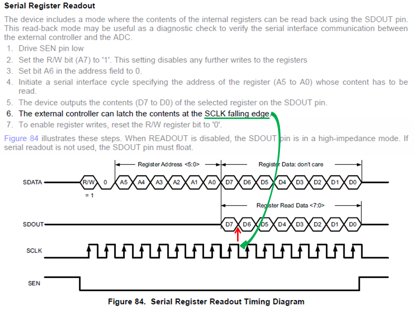

    1) On page 45 in the datasheet, it explains as follows;
        "6.  The external controller can latch the contents at the SCLK falling edge."
        However Figure 84 looks SCLK rising edge. Which is correct?
        SDATA for address looks rising edge even at Readout? SDOUT and SDATA are not same timing?

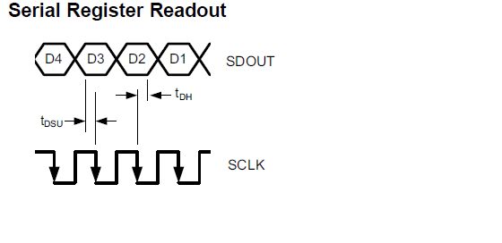

    2) I would like to make sure (again) what are
         Max tDH(SCLK latch to max SDOUT hold time), and
         Min tDSU (min SDOUT time to SCLK latch).
    (Above assumed SCLK falling edge instead of rising edge for latching SDOUT.)

  • I inserted the timing block diagram (SDOUT vs. SCLK timing) for question #2 in my previous solt.

    Q1)  The SPI interface of ADS42LB69 uses the rising edge of SCLK to latch data and address. For maximum setup and hold times for a given clock period, we recommend that the external controller uses the falling edge of SCLK to send data and address to the SPI interface of ADS42LB69.
    Q2)There is no spec for max(tDH) since it is dependent on the period of SCLK that is being used. Min tDH and Min TDSu are both 25ns.
    3)Min fsCLK>dc means to be able to read and write to the SPI interface, you need to provide a clock at SCLK. If you are not reading or writing to the SPI, then SCLK can be stopped.

  • Hi Eben,
    Thank you very much for your response. I understand that ADS42LB69 data ltach timing using SCLK rising edge, and falling edge is recommneded to use for external controller.
    I would like to make sure if my understand is correct using the follwoing figure (Figure 84 on page 45 in ADS42LB69 datasheet)
    ADS42LB69 latched SDOUT(D7) at SCLK rising edge.  Then it is recommended that external controller readout SDOUT(D7) at SCLK falling edge. I marked green and red arrows on the Figure 84.
    Is my understanding correct?
    I think that the Figure 84 needs to be corrected SDOUT location shiftted to right a little (open D7 eye  at SCLK rising edge) and SDOUT(D7) will hold data until SCLK falling edge (red arrow). Like below. Is this correct?
    Masa
  • Hi Masa,
    Yes, your understanding is correct. The ADS42LBx9 latches the data on the rising edge so we recommend the external controller to use the falling edge to launch the data
    The timing diagrams are not drawn to scale and are only meant to show the order of the address and data. All relevant timing information such as setup and hold times are given in Table 4 on page 35.
    Eben.

  • Hi Masa,
    Thanks for pointing out the differences. I have confirmed that during SPI Read, data on SDOUT should be latched on the rising edge by the external controller for both ADS42JBx9 and ADS42LBx9. The ADS42LBx9 datasheet will be corrected accordingly.
    During SPI Write, the external controller has to launch the data on SDATA on the falling edge so that it can be latched on the rising edge by ADS42LBx9
    Eben.
