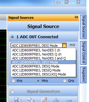

I am trying to find how to change board sampling rate (WV5 - signal source tab) to 1.6G with no success, can you help with that ?

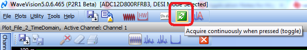

Is there a way to put WV5 to work automatically to work (FFT continuous) of computer startup (assuming ADC board is previously powered) ?

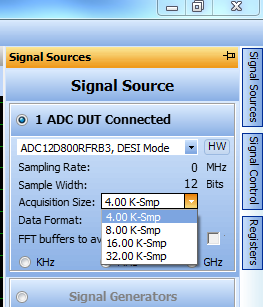

is the FFT depth constant or can be configured for higher resolution or speed ?
    Changing from 800MSPS to 1600MSPS can be achieved by changing the mode to one of the Dual Edge Sampling (DES) modes found in the Signal Sources tab on the right.
    To learn more about the different modes of operation as well as get a better understanding of how the ADC12D800RF is operating, please review the following application note: http://www.ti.com/lit/pdf/slaa617

    I'm not sure I fully understand the question, but as long as the device is powered on and properly configured it will be capturing data. The WaveVision5 software also has a continuous capture button to readback the data.
    You can adjust the capture size under the "Acquisition Size" drop down menu for on Signal Sources tab on the right.
    We have included 4k, 8k, 16k, and 32k. If you need a larger capture depth then you will need to use something other than the standard tools provided here. There is an FMC connector included on the eval board with a pass-through option that allows connecting to other FPGA development kits with larger memory depth, like the Xilinx ML605 or to a logic analyzer.
  • Thanks, it answer my question regarding 1,2,4.
    regarding 3, I mean, Is there a way to power on the computer having the WV5 starting automatically sampling FFT and showing on screen.
    I will of coarse check what other done with WV5.dll.
  • Hello Jacob,
    There is not a built in way for WaveVision5 to automatically launch and start capturing data. You may be able to achieve such a feat using scripts, but you would be better off writing some code that calls the WV5.dll to program the ADC and start capturing data. You could then create an executable that automatically launches when your computer turns on.
