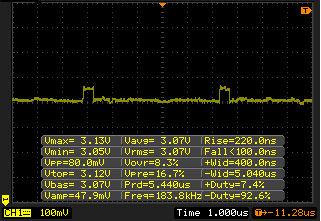

  • We disconnected the IOUTA1, IOUTA2 from everything and connected those two outputs to two 18ohm resistors which have the other end connected to AVDD (3.3V). The output on any IOUTA1, IOUTA2 doesn't look like a voltage ramp but we do see some values changing there every 16ns (period of CLKIN) - see the picture bellow.
    For self test do we need to have DCLKP/N or not? The data sheet mention only to have CLKINP/N stable for self test.
  • I don't see the picture I inserted before so I tried again - hopefully it does work.
  • Valentin,
    The Digital Self Test in the DAC5682z is not a ramp signal, but rather a digital pattern based on an LFSR (pseudo-random). You should see max and min signal toggling at the analog output at the CLK rate with various amplitudes.
    It looks like you followed the Digital Self Test Mode in the data sheet of the DAC5682z (~page 42), you should get the toggling analog output as you see.
    Ken

  • On my previous experiment DCLKP/N, SYNCP/N and DATAP/N lines were all disabled in the FPGA
    If I enable DCLKP/N, SYNCP/N in the FPGA (CLKIN/C is always enabled and is 62MHz) and I use the registers values from my previous post I get this on my scope:
    So, there is still something not set properly.
    Do you know for sure that using CM1 and offset binary together with SW_sync _sel will work?

  • Valentin,
    I just checked and the SYNCP/N signal low will send a 0 amplitude signal into the system, not all binary 0. As such the output is disabled completely (0 amplitude signal) if SYNCP/N is set low (either on HW pin or via register bit). In essence the SYNCP/N also acts as a TXENABLE function.
    The only way to use the CM1 and offset binary mode is to set the input LVDS pins to all logic 0 or all logic 1. You had mentioned you have some issues with your digital interface - are you able to set the digital interface to all 0 or all 1? Or at least the MSB? You can then use this and ensure SYNCP/N (pin or register) is high so that you do get an output. I tried your above register set on a DAC EVM with reg 0x3=0x73 (SW_SYNC enabled) and I get the expected output.
    Ken.

  • Ken,
    So we were able to set the 5 MSBs of the DAC to 0 and the common mode voltage will go down only to ~1V.
    We do get this output from the DAC:
    Is this the expected output? If we don't drive the dac DATA0-DATA10 from FPGA what is the value of these line in the DAC? Do they have some pull-up in the DAC?

  • For LVDS there are no default pull up or down. The digital levels may be random unless the voltage is pulled above or below the common mode voltage for the LVDS.
    For a DC level into the mixer, the output is outlined in Table 7 and Table 8 for the CMixer blocks. For the same DC level in A and B channels this looks correct.
    Ken.
  • If the LVDS are not driven properly they will randomly go to some digital level. The lines that can be driven properly will latch properly. You will still get some output if just the MSB are driven properly.
