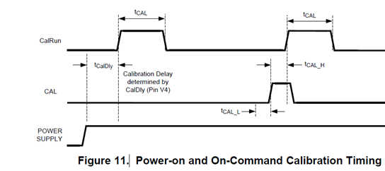

  • Hi - I'm posting for Dan since he was having some trouble getting the image to show up properly.
    In the ADC12D1600QML Figure 11 a "CalDly" term is used, but is mentioned no where else in the data sheet.  Pin V4 does not appear to have anything to do with calibration.
    My real question is whether there is any power supply rise time requirement other than that analog supply comes up as fast or faster than the others.
  • Figure 11 is an error in the datasheet. It is correct that this part does not have cal delay or power on reset. This will be corrected in the revision of the datasheet.
    There are no specific power up requirements.
