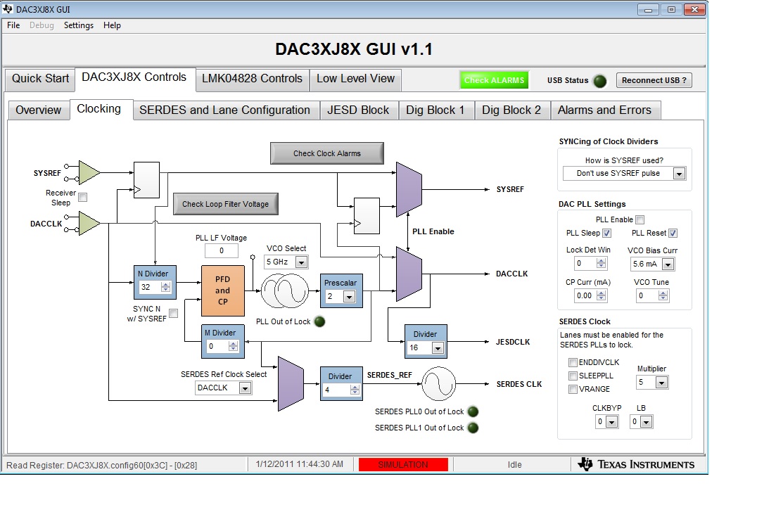

  • Hello Kang,
       There is one more question, please.
      We still can not path any PRBS pattern SerDes test. Watching with a oscilloscope ALARM terminal we noticed that the error signal has a regular (quite periodic) structure.  Might it be that we are wrong with clock the Serdes divider/multiplier settings? With DACCLK = 2400MHz, interpolation 16, x4 lane mode we want to have 3Gbps per lane. Could you, please, confirm our settings - divider and multiplier for Serdes. Though we have SerDes PLL0 locked <config108 = 0x0007>, we still can not path through the PRBS tests. Any suggestions and/or advice on the issue will be greatly appreciated.
  • Vlad,
    Your JESDCLK and SERDES CLK dividers are set correctly. I would recommend that you use the SYSREF from the LMK04828 to sync the DAC internal clock dividers to ensure all the digital logics inside the DAC core are initialized correctly. We have the clock divider reset logic set by default to pay attention to the 2nd SYSREF pulse, assuming the same DC coupled network as the EVM.
    A while ago while debugging the Xilinx platform + DAC38J84 with one of our customers, we noticed that when both ours and their VC707 SERDES/JESD side are based on QPLL, we cannot get the DAC38J84 to pass the K28.5 training sequence. This was confirmed on both our side and their side. Only when we switched to CPLL we were able to get the K28.5 training sequence to pass. Since the K28.5 and PRBS are both non-fixed pattern, I wonder if you are seeing the same thing. Since I am not too familiar with FPGA, I am not too sure about the root cause and the latest update. You may want to touch base with Xilinx support rep regarding the PLLs to use for the IP.
    I will also ping our colleague to see if he knows the latest status. Will keep you updated.
    -Kang

  • Hello Gentlemen,
    We have fixed the issue. Now the DAC is working. Thank you very much. The reason was in DAC and TX side SerDes lines start-up sequence. The SerDes lines should be active from JESD204 TX side at the moment when the DAC comes out of reset/init sequence.
    Thank everybody one more time.
    Vlad.
