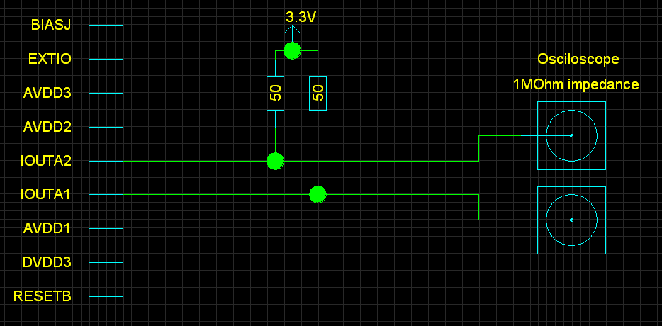

I am trying to make the DAC5682Z to output the same signal on A and B channel. I am using a custom made PCB.
I am providing the DAC with a 900MSPS data and a 900Mhz clock.
Settings:
PLL and DLL are disabled. FIRs are disabled. Single DAC mode set. B_equals_A is enabled. See configuration registers below.
Outputs of the DAC are pulled up to 3.3V using 50 Ohm resistor. I’m measuring them separately with Oscilloscopes (1Mohm input impedance). See picture below. Both channel A and B have the same output circuit.
My problem is:
I see signal on DAC output channel A but I don’t see anything on channel B.
It is not a soldering issue (I have the same issue on two boards).
Do you have an idea what might cause that?

Circuit:

  • Hi Jakub,
    I have checked in the lab with our DAC5682z EVM to see if operating under 1x1 mode (i.e. DAC5681z mode), the B_equals_A mode would work. After verifying on the bench, I have confirmed that the B_equal_A mode does *not* work in single DAC mode. This only works in dual DAC mode.
    I believe the original intention of the single DAC (1x1 mode) is meant for the DAC5682z to work as an DAC5681 or DAC5681z mode, which only has single DAC output on channel A. Therefore, whenever dual_DAC mode is set to 2b'0 for 1x1 mode, the equivalent logics for dual DAC mode will not work. If you look at the DAC5681z datasheet, the datasheet had listed the B_equals_A mode (config3, bit 2) to be fixed to 2b0 only.
    -Kang
  • Thank you for answer.
    By the way my problems with confusing readouts of STATUS0 register were caused by fact that I left VFUSE pin floating (not connected to 1.8V as it should be)
