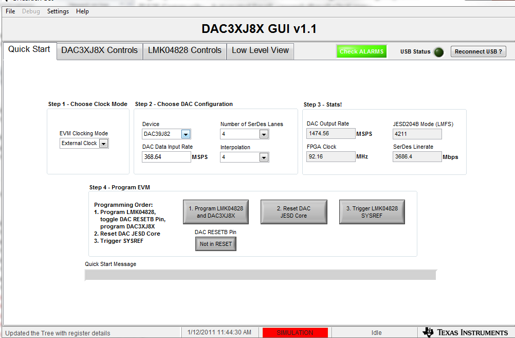

  • Hi Allen,
    You may download the DAC3xJ8x EVM GUI. The main page provides all the calculation for the clocks, and the low level page tells you the equivalent register settings
  • Hello Kang,
    Can I see the register change in low level view when I change something on GUI while not connected to actual EVM board?
    Load/Save config is supposed to work without connection to EVM?
  • Hello Jin,
    Yes, the GUI has a simulation mode that can work without an actual EVM board connected to the PC. In the simulation mode, you may view each register changes in the status log. Simply double click on the lower left hand corner and the status log will show up.
    You may always load the register config file. The saving config feature works intermittently in this version. After you save, you may want to reload again to make sure it saves correctly.
