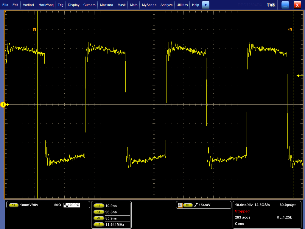

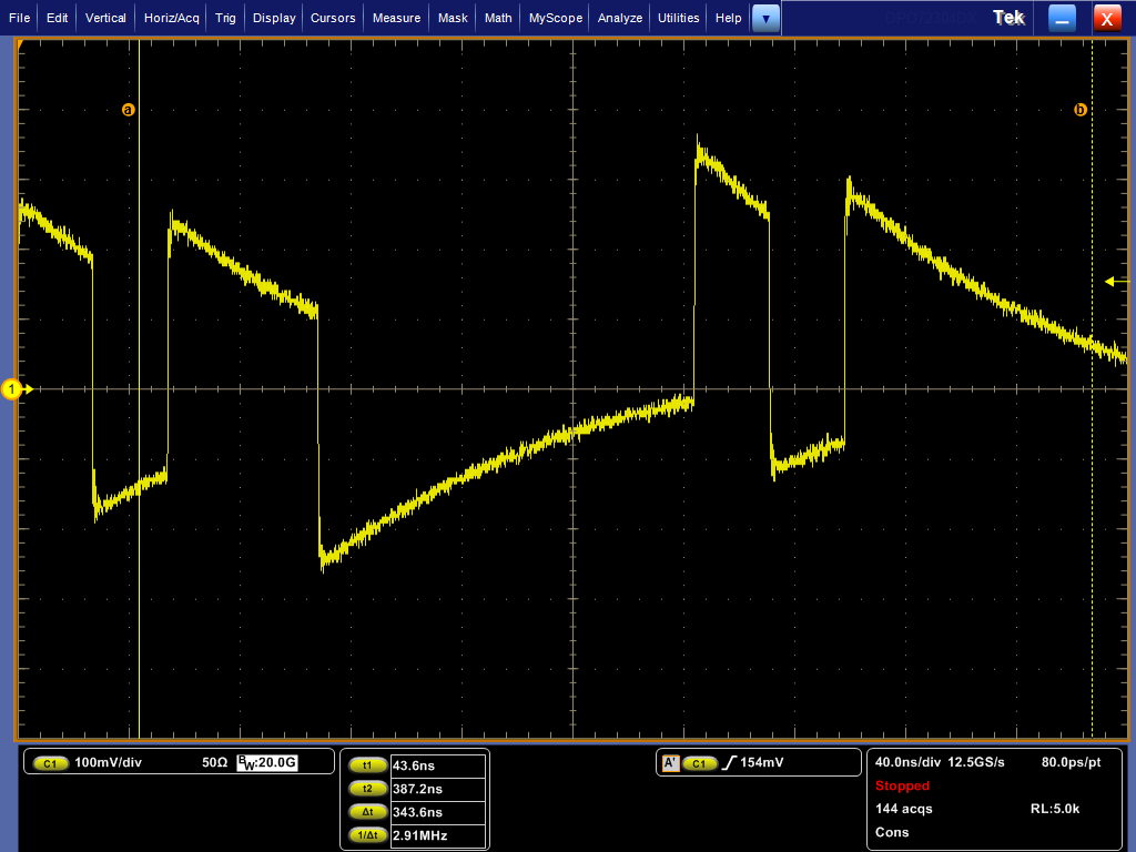

Hi everyone,
I'm using DAC38J84 to generate NRZ signal. However, the waveform I generated doesn't have a flat top/bottom.
Firstly I generated PRBS sequence whose length is 2^7-1, and the bit period as 27ns. I use this PRBS sequence to generate NRZ signal, and the NRZ signal has 10 samples in each bit period. However, the DAC output waveform does not have a flat top/bottom.
I also tried to generate square wave, whose period is 27ns and duty cycle is 50%. But the generated square wave still doesn't have a flat top/bottom.
I used Integrated Logic Analyzer to monitor the data that has been sent into the JESD IP core, and verified that the data is correct. I also generated sinusoid wave and triangular wave, and the output are correct.
Can anyone tell me how to fix this?
Thank you!
Tong
  • Tong,
    The DAC38J84 has a transformer output which has a 1dB passband from 50M-1G.  The fundamental frequency of the pulses you are trying to pass through this are below this frequency so the main frequency component of the pulse is being attenuated (37M).  This causes the pulses to droop.  The wider the pulses, the more the fundamental is attenuated and you see more pronounced droop.  The way to mitigate this is to use a faster pulse to get the fundamental above 50MHz, or use a similar transformer with lower frequency range.  Check out the ADT2-1T as a possible alternative transformer.
    Ken.
