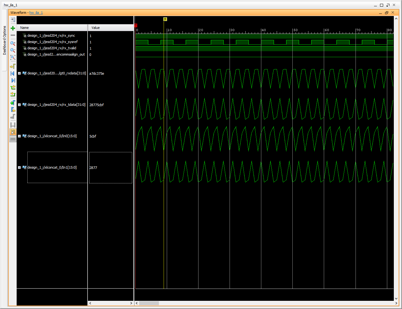

  • Hi Jim,
    Thanks for the reply. I am now getting data from the JESD core after using 2.7 GHz sampling clock with the following settings
    Table
    Table 27. Decimate-by-20, DDR = 1, P54 = 0, LMF = 1,2,4
    However when I set 0x58 = 0x4 I only get noise, but when the JESD Test pattern is used
    0x58 = 0x0
    0x202 = 0x49 (Modified RPAT Test  Mode)
    I get this, can you have a look at it and let me know if this is what you should expect? Our signal generator is out for calibration so we can only use the internal pattern generator for now.
    Rgds,
    Stephen

  • Hi Stephen
    From your earlier post it looks like you are getting some data through the link in D20 DDR mode, but it's not clear it is the correct data. I set up an EVM in D1 DDR and D20 DDR modes at 2700 MHz clock and gathered some data that may help for comparison purposes.
    The data exported from HSDC Pro Time Domain view is in this file:
    /cfs-file/__key/communityserver-discussions-components-files/73/2330.ADC12Jxx00-D20-DDR-Output-Data.xlsx
    The HSDC Pro plot data is in this .ppt.
    /cfs-file/__key/communityserver-discussions-components-files/73/8446.ADC12J2700-debug.pptx
    Please note that in D20 mode, the output data is signed 2's complement format. We normally pre-process the data before display in HSDC Pro by XORing the sign bit with 1 to change it to unsigned data. Some of the spreadsheet and plots were processed with this feature disabled to help illustrate the raw data coming out of the link, while others were change to the normal processing to make the waveforms give the expected shape. The only difference is the polarity of the MSbit.
    I don't have a spare TSW14J10EVM, but they are readily available at the TI store here: https://store.ti.com/TSW14J10EVM-JESD-Converter-EVM-to-FPGA-EVM-adapter-P5235.aspx
    I hope this is helpful.

    (REG_POR_0x21,         0x00);                 // Initiate reset of all registers
    (REG_POR_0x21,         0x01);                 // De-assert reset
    (REG_CLKGEN0_0x30,     0x00);            // SYSREF receiver and processor off
    (REG_SERCFG_0x40,         0x04);                // Set serializer pre-emphasis for high speed PCB
    (REG_T_CAL_0x66,         0x03);                // Foreground calibration mode with timing optimization enabled
    (REG_OVR_N_0x208,         0x07);                // Change over-range processing to longest interval
    (REG_CAL_CFG1_0x51,     0x84);                // Calibration optimized for large signals
    (REG_JESD_CTRL1_0x201, 0xDE);                // A6 Scrambler on, KM1 = 23, DDR, JESD disabled
    (REG_ADC_PAT_OVR_EN_0x58,    0x00);                // EN ADC Test pattern
    (REG_DDC_CTRL1_0x200,     0x32);                // 6.02dB gain, decimate-by-4
    (REG_JESD_CTRL2_0x202, 0x84);                // P54 PLL on, Differential SYNC, Normal data mode
    (REG_JESD_CTRL1_0x201, 0xDF);                // A7 Scrambler on, KM1 = 23, DDR, JESD enabled
    (REG_CAL_CFG0_0x50,     0x0E);                // Initiate a foreground calibration
    (REG_NCO_PSET0_0x210, 0x12);
    (REG_NCO_PSET0_0x211, 0x11);
    (REG_NCO_PSET0_0x212, 0x11);
    (REG_NCO_PSET0_0x213, 0x11);
    The clocks provided are as follows
    ADC_DEVCLK = 1600 MHz
    ADC_SYSREF = 8.33 MHz
    FPGA_REFCLK = 200 MHz
    FPGA_CORECLK = 100 MHz
    FPGA_SYSREF = 8.33 MHz
    Thanks and Regards,
    Stephen2577.ADC_Circuit.pdf
  • Hi Stephen
    Your schematic looks OK as far as I can see. Is the ADC DEVCLK AC coupled from the clock driver as required?
    The only question I have about the register settings is the value of REG_JESD_CTRL2 which is 0x84h. This disables the differential SYNC and uses the single ended SYNC. I believe that is your desired configuration but wanted to confirm.
    I would also recommend setting the NCO frequency/phase values before enabling the JESD204B interface. This isn't super important if you are only using a single ADC, but if you needed to synchronize the NCO of multiple ADC devices then it would be needed.
    All of the clock frequencies you list are correct for a Xilinx FPGA.
    I confirmed on my setup with Altera FPGA that the firmware does assert SYNC even if the ADC board is not outputting clocks or data.
    Jim B
  • Hi Jim,
    Yes, as you can see our FMC has providion for both differentila and single ended SYNC signal.So I was trying both this one was using SE Sync. We are using only one ADC but I will implement your recommendation and see if that gives anything.
    On Xilinx FPGA the SYNC signal is only asserted when the clocks are present.
    Rgds,
    Stephen
  • Hi Jim,
    Didnt make any difference. Its behaving the same.
    What else can I look at to debug?
    Rgds,
    Stephen
  • Hi Stephen
    I would compare all of the detailed signals at the FMC connector. Something must be different between the ADC EVM and your DAQ module in terms of location, signal level, etc.
    I don't have that information from your board, so I don't know exactly how the clocking circuitry and other FMC signal routing are done.
    Jim B
