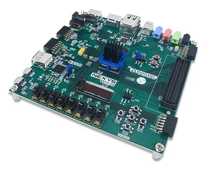

    Going by your suggestions, I am considering the Nexys Video Artix-7 FPGA Board by Digilent. It has a FMC connector. Our department is planning to purchase a Virtex / Kintex board in the near future but since I there is no definite time given (budgetary problems), I suggested the Nexys Video Artix-7 FPGA Board for the time being. Will it be able to solve my problem? Reference manual is at: [https://reference.digilentinc.com/reference/programmable-logic/nexys-video/reference-manual]

    Be careful.  I don't know the pinout of the FMC connector on that board.  When the adapter board was developed to bridge from our EVMs to the Xilinx FMC connector, we did not pick the routing to the FMC connector.  We had a Xilinx person do that, so that the LVDS clock signal went to connector pins that eventually connected to clock-capable IO pins on the FPGA, and the rest of the LVDS pairs went to FMC pins that eventually connected to LVDS inputs on the FPGA.   If this board you are looking at copied the Xilinx FMC pin assignment, then you should be ok.   But the schematics for the ADS5474 EVM are in the user guide for the EVM on the TI web, and the schematics for the adapter card are on the TI web for that board.  You would need to take those two schematics and trace out each signal from the ADC through the Samtec connector and then through the FMC connector and then through the FPGA board up to the FPGA pins in order to know that each signal is getting to the FPGA and on LVDS capable inputs.  You will need to know that info anyway in order to be able to create your FPGA pin constraint file for when you start to write HDL code for the FPGA.
