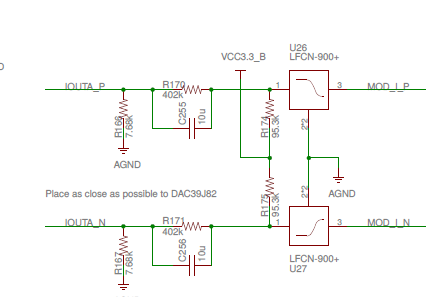

  • Jim,
      At your advice we removed the large array of resistors and the LFCN-900+ and replaced with a direct connection to a DLFCV-1000+.  Do you see any problems with that? I'm inserting a picture of the change.
    Do you see a problem with this change, noting that there's a 100 Ohm resistor between MOD_I_P and MOD_I_N?
  • Kurt,
    Sorry for the delay.  Jim is out on vacation this week.  I will try to cover as best I can.
    Your previous circuit seems to have some DC shift network with a bypass cap for high frequencies.  This implies that you have different DC bias/common mode requirements for the DAC vs the IQ modulator.
    My only question is if this requirement is still needed with the 2nd circuit.  Are you still meeting the common mode requirements of the IQ mod?
    Also the DAC requires a resistive termination at the IOUT pin (current source).  Do you need a 25 or 50 ohm to gnd on IOUTP and IOUTN?  I'm not very familiar with the minicircuits LPF and how it needs to be connected.  The data sheet seems to imply the only components in the filter are LC and you may need a source and termination resistor before and after the filter.
    Ken
  • That's what I was expecting to hear.  I think I do need a 50 Ohm to ground on IOUTP/N.  Additionally, I think we're ok in terms of common mode.
    Kurt
  • Ok - keep in mind the DAC will source an avg of 15mA DC (mid level) when there is an AC signal so depending on the load of 25 or 50 ohms you will have this as the common mode - as long as the IQ mod is ok with this and the swing on IOUTP and OUTN then you should be ok.
    Ken.
