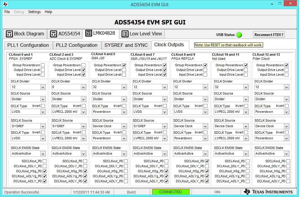

    In the ADS54J54 EVM GUI software I am using the configuration file ADS54J54_500M_841.cfg, it is assumed that with this file you have a sample rate of 500MSPS without decimation, below I put the screens of its configuration parameters, according to the JESD Configuration screen, L = 4, F = 1, K = 32

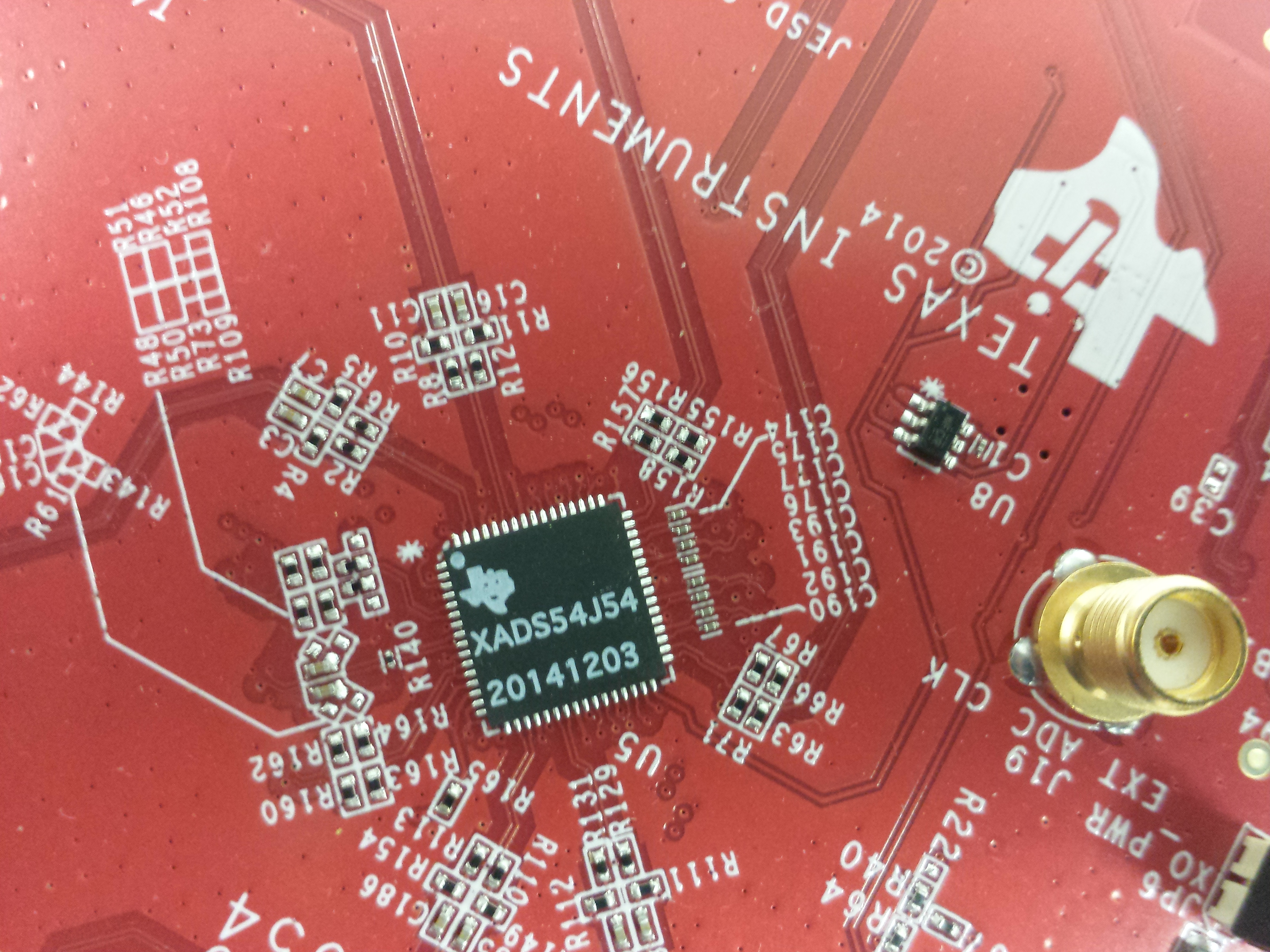

    But maybe a WebEx session could shed some light on what is going on.  While we see about setting that up, may I ask what the markings are on the top of the ADC that is soldered on to the ADC EVM/    What part number is inked on the top of the ADC, and the likes below the part number that indicate the device assembly lot code?
    Richard P.
  • Hi Richard
    The number inked on the ADC is:
    XADS54J54
    20141203
    I attach a photo so that you can see it
    Thank you.   That matches the EVM that we are using in the lab, and eliminates one possibility that I had considered about maybe an error in assembly.  So I suggest we set up a WebEx so we can take a good look at each other's setup.

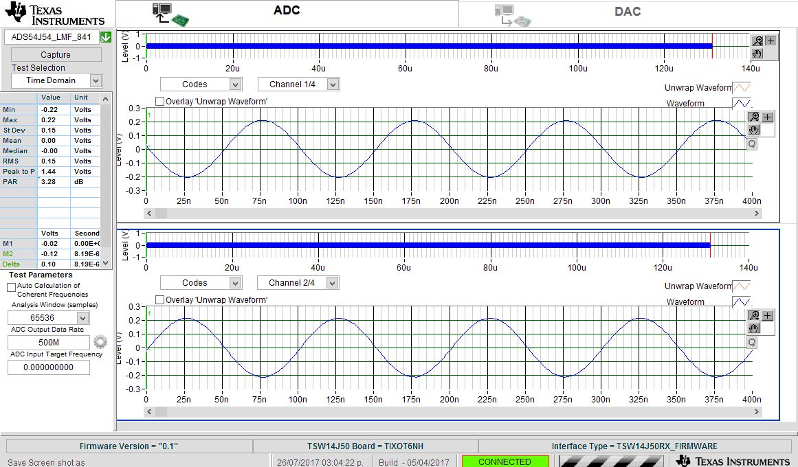

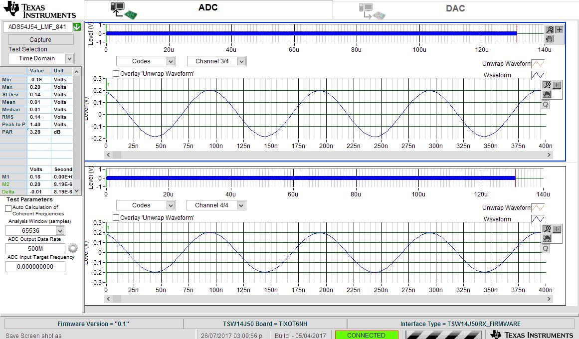

  • Hello Richard
    I tried the files you sent and they did not work, I downloaded version 4.7 of HSDCPro and it worked fine.
    There is only one problem, when feeding the same signal to two channels at the same time, the combinations with channel B are out of phase, ie A and B, B and C, B and D.
    If the remaining combinations are used, the captured signals are in phase
    I sent the screenshots for you to observe this situation
    regards
    Ivan
  • Hi
    I am glad you got the capture working.
    Looking at the EVM schematics I can see that the channel B input signal is inverted through the transformers before it gets to the ADC.  For channel A I can see the single ended signal coming in on SMA J1 and tracing that though the transformers I see it goes to signal named AINP.  But for channel B I see the signal coming in on SMA J2 and tracing through the transformers I see the signal going to BINM instead of BINP.  To flip the polarity of channel B back to what you wish I think you would need to solder in an SMA connector to fill the unpopulated spot of SMA J12, and then remove grounding resistor R9 and install the zero ohm grounding resistor R49.   That would bring the channel B signal in on the other side of the transformer primary.  Thank you for pointing this out.  I had not noticed that before.
    Richard P.
  • Hi Richard
    Did yo mean remove R49 and then install it in R9?
  • ah, yes. I drew it correctly in the drawing but stated it backwards in the text. Remove R49 and install it on R9. And install J12. it is pretty tough to remove one of those SMA connectors by hand to move it over from J2 to J12. We usually just add a new connector and leave the old one in place when we wish to install the other side of the pair. But maybe with a hot air pencil above and a hot plate below the SMA could be removed but you don't want to overheat the transformers too much.
    Richard P.
