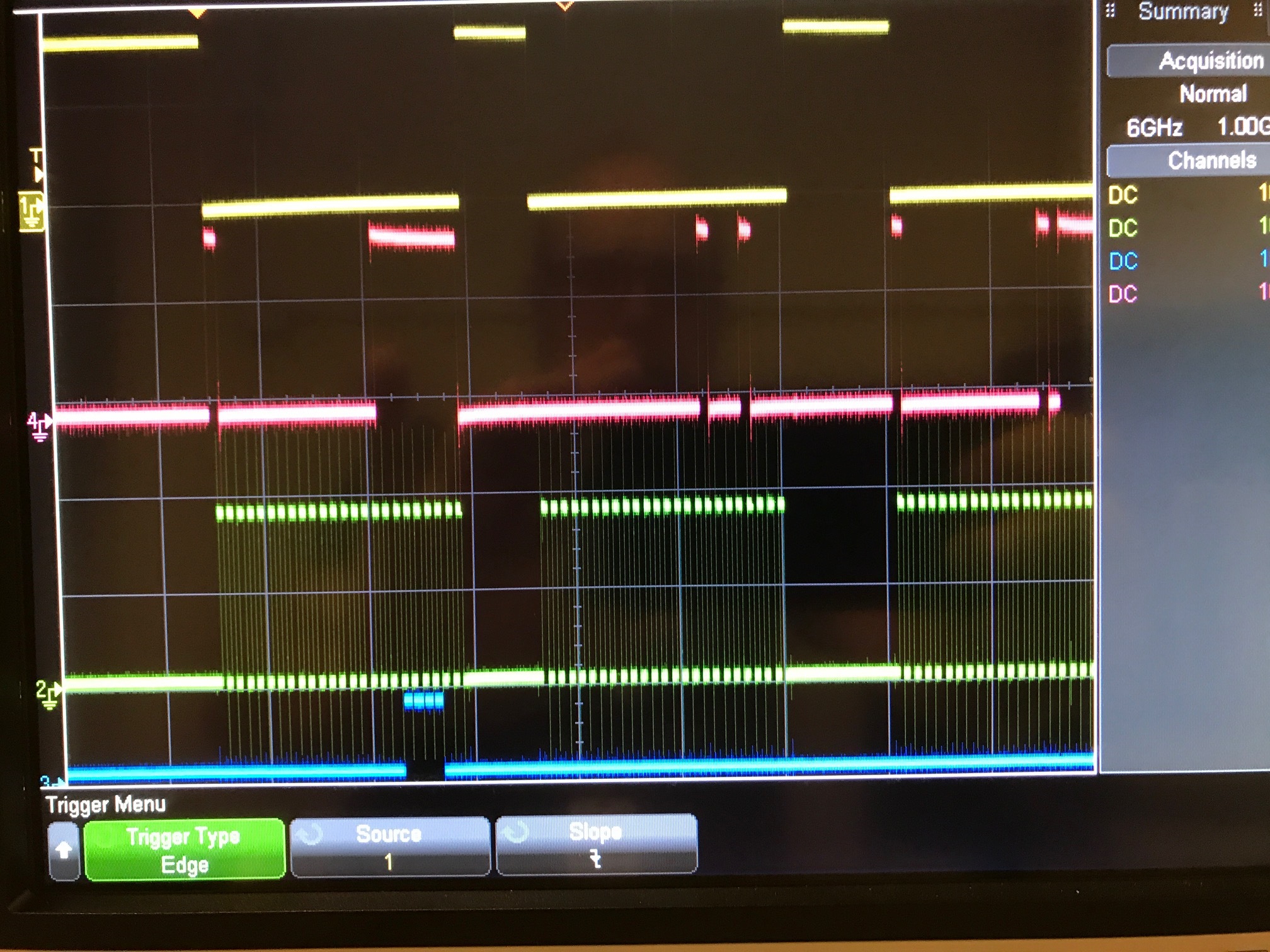

I've got a design with two ADC32RF45's on it.  In the design I ran common clk, SDI, SDO wires to both chips.  That is, the clk lines are hooked together to one pin on the FPGA driving it, the SDI pins are tied together and so are the SDO pins.  The chip select pins are obviously not hooked together.
My problem appears to be that the SDO output does not appear to be reaching full voltage.  Have a look at the photo.  The yellow, red and green lines are the CS, SDI and CLK respectively.  The blue is the SDO and appears to be reaching about half it's output.  My question is, is it OK to tie the SDO's together, or will one of the SDO's pull the other low?  There is very little information on this actual interface in the datasheet, so it's hard to determine what's going on.  It's also quite possible that my FPGA guy has screwed up his pin assignments.  He told me just yesterday that he had SDI and SDO swapped, so who knows what else he's done wrong.  But as usual, firmware must be troubleshot with a scope :).
We can always run the chip in 3 wire mode if we need to, but I'd like to understand this problem.  If I did screw up by hooking the SDOs together, I want to fess up!
Thanks in advance!
  • It turns out when I un-hook one of the SDOUT pins, the logic rises to the proper output? So, it appears that despite the chip select, the non-accessed SDOOUT pulls down the output of the used SDOUT? Shouldn't the chip select put the non-accessed SDOUT in tri-state to allow multiple of these devices to share the same 4 wire bus? I think we will be able to run in 3 wire mode, but if I am correct in this assumption, then this chip is flawed in my opinion.
    Thank you for the follow-up findings.  I will take this to the design team for comment.  On our EVM we just have the one device, so the SDO pin is not being shared with other ADCs.  I scanned the datasheet and I do not see any statement that the SDO pin is high impedance when not outputting the read back data.   But I do see in the diagrams for the SDO format (figures 118 and 121, depending on revision of the datasheet) that the SDO is drawn as 'low' in the time leading up to the output of data, rather than what I sometimes have seen in other datasheets as drawn as mid-scale to indicate high impedance until the device is driving the readback data.  So it seems that the SDO pin is not high impedance when not in use.

  • I'm pretty disappointed in TI for letting this part out with this flaw.  Luckily I only have 2 devices on board and was able to put an OR gate on the SDOUT pins.  In addition, my firmware guy was able to put it in 3 wire mode which seems to work fine.  You should add some information to the datasheet ASAP so that others don' screw up their designs using this VERY expensive part.

  • Did you find any better way to work around this? It appears that if you put the device in 3-wire mode that it _still_ drives SDO, so while it "works" it means that it disrupts all other devices on the SPI bus unless you pull the connection to SDO.
  • We ended up going back to 4 wire SPI and running the SDO to an OR gate. In the final design we ended up just running the SDO to a separate pin on our FPGA. Bothersome but workable.

    Yes, the SDO pin does not tri-state when the SPI is not enabled so the SDO cannot be bussed amongst a number of devices.   On our EVM we have three devices with SPI ports, (ADC and two clocking devices) and the clock and SDIO signals are bussed, but the enables get their own signal each and the readback gets their own signals each.   The USB device has 8 GPIO pins so that worked out - three SPI enables, three readback pins, a common clock and a common SDIO - for a total of 8.   I agree it would have been more flexible if the designers had thought to turn off the SDO driver when the device SPI was not enabled.
