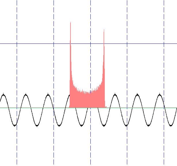

I am developing an 1Gsps ADC board using ADS54J60.
It sends data by JESD204B using optical fiber.
The operation of JESD204B is going well.
Taking a code histogram at the input voltage difference is 0, it was like a comb !
When the least significant bit of the ADC code is "01", it seems to be larger.
According to the datasheet there is a description "Default 14-Bit Data" on Fig.60.
Does ADS54J60 have only 14bit resolution??

  • Hi Jim.
    I understood that one ADC of ADS54J60 consists of four ADC cores and working of DC corrector.
    And I also tested external offset and confirmed that it works properly.
    If the DC correct ion mechanism does not work well, indeed, I confirmed waveform in time domain will be a comb one of four.
    But what I am in trouble is that not waveform but the code density histogram is a comb .
    The mechanism of DC correction gave me a great hint.
    ADC A and B are each consist of four 250 MHz ADCs in ADS54J60.
    I call them ADC A1, A2, A3, A4, B1, B2, B3 and B4 here.
    I tried to make histograms separately for the codes output by these eight ADCs.
    I attach the figure.
    I divided this into A1, B1 and others.
    Please see histograms of first 2 cores.
    ADC A1 and B1 are outputting only the code whose LSBs are "01" !
    Every "00", "10" and "11" are missing codes !!
    It seems that ADC A1 and B1 have only 14 bits of precision.
    Other ADCs, i.e., A2, A3, A4, B2, B3, B4 are outputting good histograms and they have 16 bit resolution.
    Why are the resolutions of two of the eight ADC cores low?

  • Hi Jim.
    Thank you for reply.
    No, I don't have an EVM.
    I use my handmaid board. (photo above)
    Least significant 2 bits (of only one lane per ADC) are not toggled in normal operation.
    But all 16 bits are toggled when JESD204B scramble enabled, so my data decode logic and ADC's digital block seems good.

  • Hi Jim.
    When I set this register, ths behavior has surely changed but it is not perfect.
    I will report detail tomorrow.
  • Hi Jim.
    I tried add following register setting and measure histogram 5 times.
    0x4004 0x6A -- hidden page
    0x4003 0x00 -- hidden page
    0x6012 0x02 -- Always write 1 bit added in latest datasheet.
    0x4004 0x68
    0x4003 0x00
    0x6052 0x01 -- Set gain validity
    0x6044 0x21 -- set default gain to +0.25dB
    0x60AD 0x04 -- Always write 0x04 ( datasheet is updated)
    0x60AB 0x01 -- validity for LSBbit select
    0x6000 0x01 -- digital core reset
    0x6000 0x00 -- digital core reset remove
    As a results, histgram was changed obviously.
    From the least significant 2 bit, ADC data and fixed value are output alternately with the passage of time.
    And by this modifing, bit[0] is seemed ADC data but I thought  bit[1] is not ADC data.
    Each bit[1] of four sub ADCs are  same value and periodically change
    It seems the resolution is 14 bits practically.

    Unfortunately right now we have a ENOB around 10 bits and this is related to the "comb histogram".
    I am eager to know if there is a solution for that.

  • Jim,
    Thanks for the link. Me, I didn't see this file before but we build our own board similar to that.
    We invest a lot of time to understand what happens with the histogram of the single converter (ADC channel samples decimated by 4) and why are missing, some time, 3 out of 4 consecutives values.
    I have attached a few screen grabs with good or bad histograms. I am running a command between captures (see the code below) that randomly change the look of the histogram.

    Bad Histogram
    Good histogram
    Bad Histogram Zoom in
    Normal Histogram zoom in
    Help me to understand what's happening.

    This a 4 channels acquisition board and we are expecting to have a ~11bits ENOB.
    You ask if I am getting this histograms with the new registers settings: registers 0x6052/0x6044 settings helps for the "clipping wave" issue but not for the histogram.
    Do these occur after every power cycle?: Yes
    I am working with Patrice Plante. I do not know Kyuiji.
  • Jim,
    I want to be more precise on the digital gain registers: digital gain enabled with a value >=0x21 will remove the "clipping wave" but the histogram will be always "bad".
    With the digital gain disabled or enabled but =< 0x1F the histogram will switch randomly from "bad" to "normal" after each "DC level calibration command" (DC_freeze).
