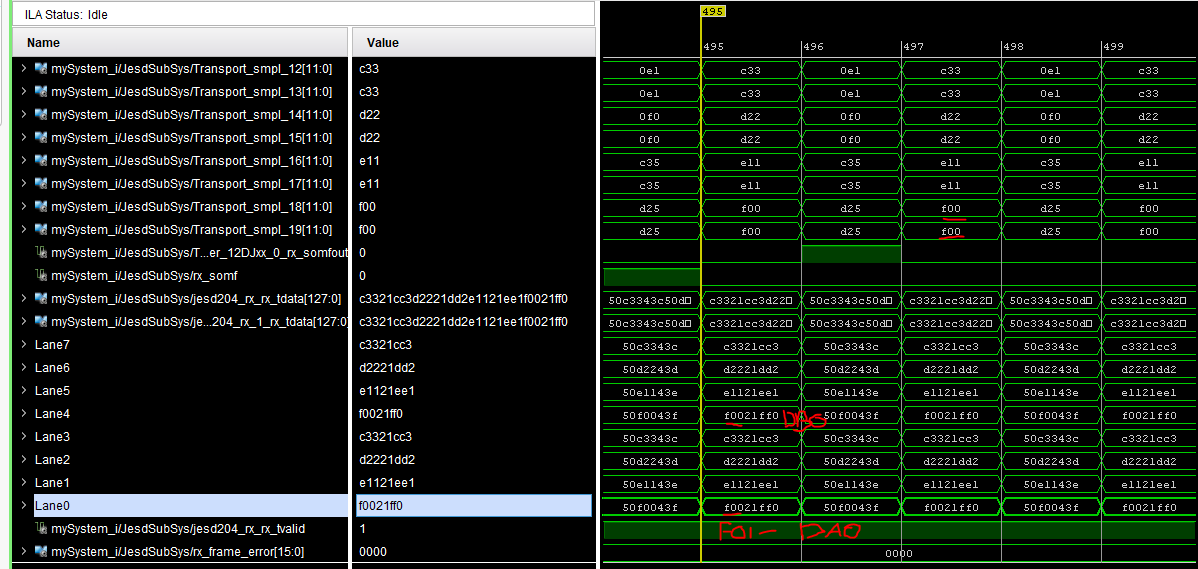

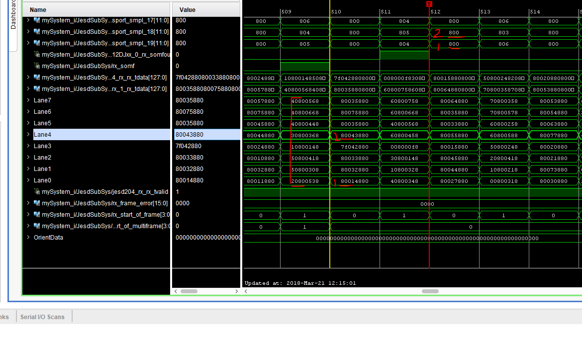

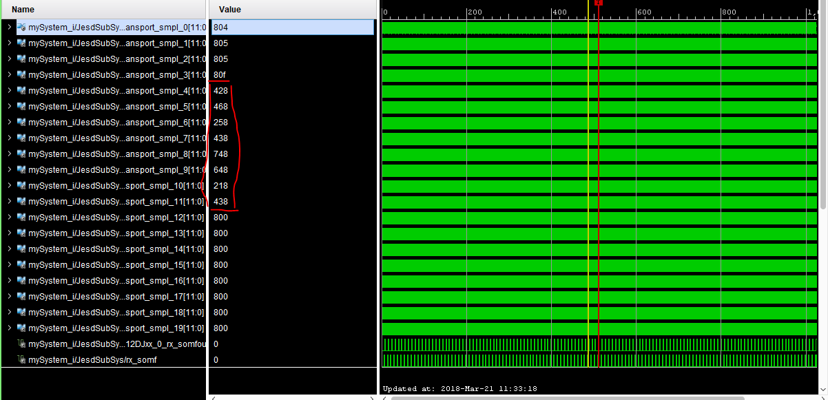

I modified the KCU105 reference design to conform to the ZCU102 dev kit.  I am able to see an aligned ramp pattern across all lanes but when I try to sample a terminated input the samples out of the TI transport code looks off (and out of the JESD core itself).  I have the following:
The Lane Data out of the core does match what come out of the transport layer.  I am suspicious there is a lane mismatch or something similar.  The out of sequence occurrence appears to be synchronous.  The image below shows that.
The reference design mapping is confusing so I may be interpreting something incorrectly but I have tried a few iterations.  Below is what I mapped for the reference design.

Lastly the only way I was able to achieve ramp alignment and incrementing is to use 2 JESD cores in the FPGA, which then matched all JESD parameters, like L.  The outputs are concatenated and fed to the transport code for sample extraction.

    I tested the alternative clock buffer approach and it did not fix the issue.  I did not realize that Xilinx did the initial KCU105 design.  The user guide really only shows the ramp pattern so I am wondering what was done for transport layer verification.  When I enable the transport layer test pattern I see the attached results.  There is clearly a byte ordering issue.  I have reached out to my FAE at Xilinx to try and work it from that side.  Have you seen anything like this before?
    Thanks!

    I think the octet ordering shown is OK for Transport Test mode. It's tricky to decode by hand at first because the earliest octets are at the right within the 4 octet groups.
    Taking DA0 (Lane 0) as an example for the 495 and 496 octet groups:
    f0021ff0 50f0043f
    Starting with the rightmost octet in the first group and organizing from earliest to latest:
    • F0
    • 1F
    • 02
    • F0
    • 3F
    • 04
    • F0
    • 50
     Regrouping into 3 digit hex (12 bit binary) values gives
    F01 sample 1
    F02 sample 2
    F03 sample 3
    F04 sample 4
    F05 sample 5
    0     tail bits are 0000b
    This matches the information for DA0 shown in Table 40 in the ADC12DJ3200 datasheet.
    I hope this is helpful.
    Jim B
  • Jim,
    Thank you for that explanation, that data makes a lot more sense now.  The resolution is now contained within the transport code in the FPGA.  It is curious that the ordering on the Zynq MPSoC is different than what was verified in the Kintex KCU105 board but it is an easy fix.  I have seen posts on Xilinx forums about byte orders changing with parameter changes so I guess this is just something we will need to track and mitigate.
    I appreciate the help!
