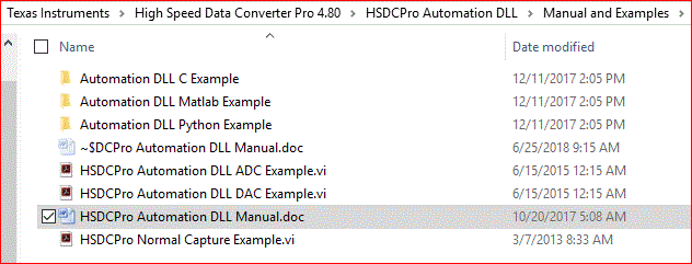

  • Hi Yanlin Xu,
    The HSDC Pro User's Guide explains the software trigger.
    Once HSDC Pro is installed, you can find the "HSDCPro Automation DLL Manual" which will explain the trigger functions in more detail.
    Hope this helps.
