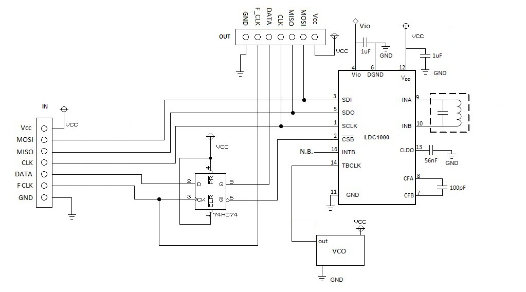

  • Hi, this is the schematics. The idea it two connect N number of devices in series.
    I tried pull-up and pull-down R (10k-30k) on the MISO line. As well as a R (330) in series.
    The datasheet mentions about the SDO: "It is high-z when CSB is high", it is evident that including a second LDC on the SPI bus affects the SDO data. My test shows exactly that.
    So how to handle the the SDO and/or CS  properly, making sure that on the SDO only one LDC is transmitting and not interfering? Or what am I missing.
  • It is not clear from the diagram what the timing of the CSB look like. What I would suggest to do is to use a demultiplexer logic CI (such as 74HC138, 74HC154) to distribute the CSB control. Timing wise, select the demultiplexer output first before setting CSB low.
    Good luck!
    Don
  • Hi Don,
    I am using D-type FF as a shift register, shifting one bit, so after I send a pulse to the FFs (CS low on the first LDC), I then begin the SPI transfer. Then the uC sends a second pulse to select the next LDC.
    In each iteration I make sure I to set all FFs Q' (CS) high before beginning the reading process.
    I chose this shift-register solution since I only have two lines to control the CS (besides 3 lines for SPI and two for power/gnd), and be able to control N number of them, physically separated (that is, each one with their own 'CS selector'). What I am struggling with is, if the FFs seems to be working good, and the LDC are correctly programmed (one by one, ergo MOSI line is ok), problem appears when reading.
