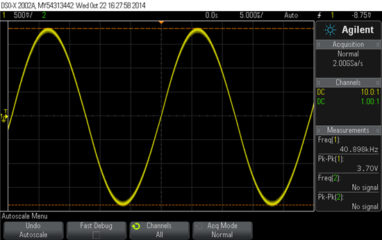

Below is the wave form between the coil.
This resonant signal looks all right.

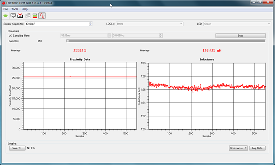

  • I checked the AC resistance of the coil at 40 kHz.  It is a little bigger than DC resistance.
    I found that Rp is 837 ohm.  A little bigger than 798 ohm.  Maybe there should be more margin.
    So, I changed the frequency from 40 kHz to 60 kHz.
    I decresed the C from 100000 pF to 47000 pF.
    Rp in now 1674 ohm --- much bigger than 798 ohm.

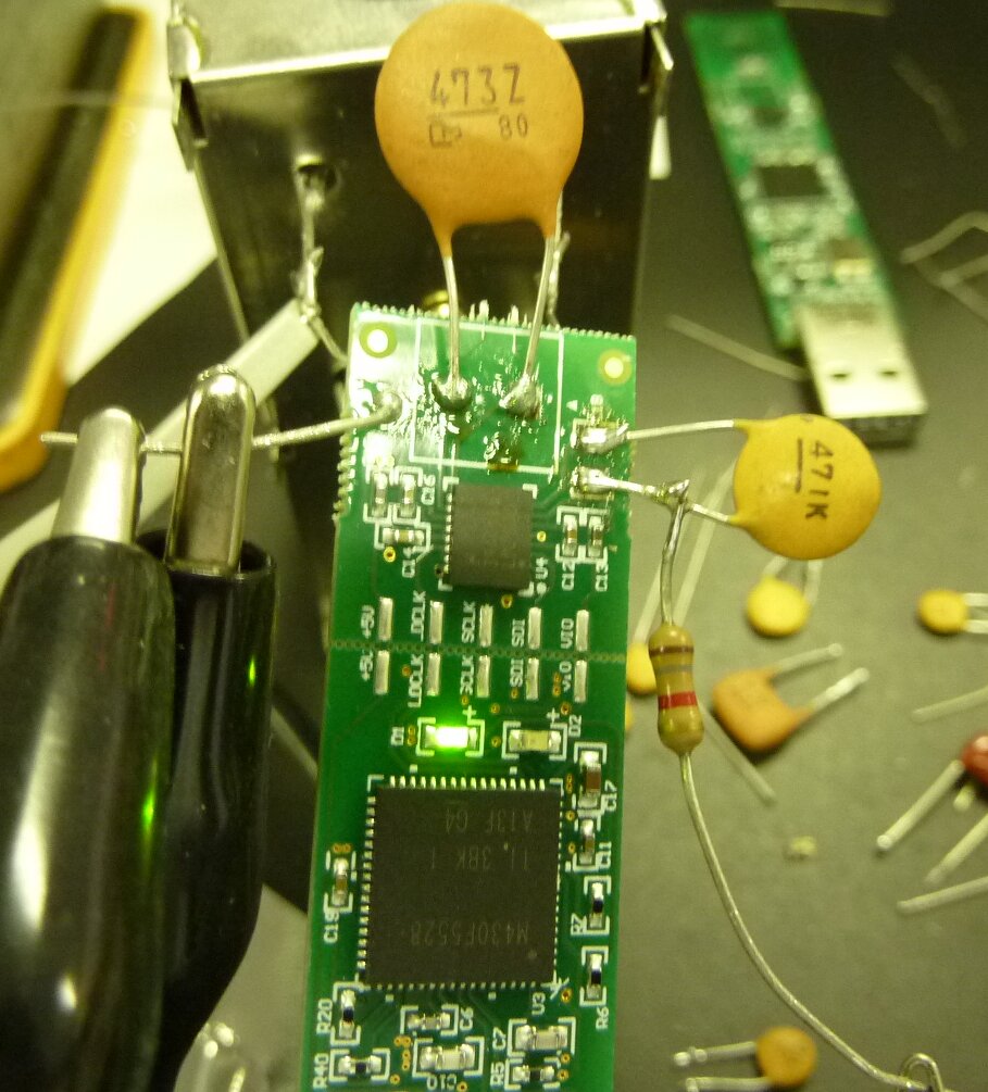

    Then I increased the C18 ( CFB ) from 20pF to 100pF than  470 pF.
    Now the CFB voltage is a little below 1.0 Vp-p.
    I soldered 1.8 k ohm series resistance to CFB terminal as below to monitor the waveform.

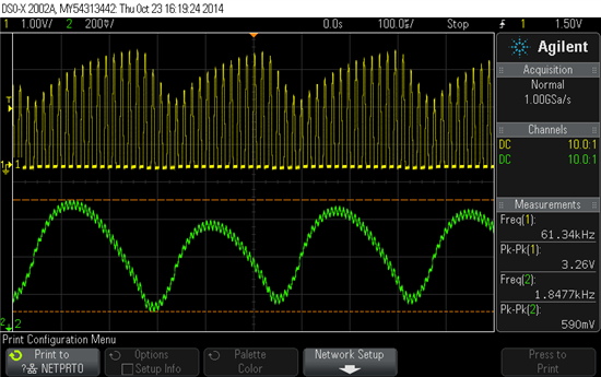

    Then I monitor the CFB by oscilloscope.
    Ch1 is waveform at INB.
    Ch2 is waveform at CFB.
    Voltage = 590 mVp-p almost 1.0 Vp-p
    This waveform is the voltage between the coil ( between INA and INB )
    Is this the waveform when the LDC1000EVM is configured correctly ?
    Or shoud I change something ?
    There is one more problem.
    Inductance value is not stable.
    L is changing slowly between 125 uH to 128 uH.
    How can I get more stable inductance value?
    When I tried at 40 kHz, although the CFB voltage is very low, inductance was 10 times more stable.
    What should I do?
    The INA/INB signal you have shown is reasonable. I have two recommendations on the L stability - first, it looks like your inductor is a few cm away from the LDC1000; you should twist the wires between the LDC1000 and the sensor.
    Next, it is important to use a high-quality capacitor for the sensor; I don't know if the disk capacitor you are using is a NPO or C0G grade, but that is the recommended type of capacitor. Finally, the sensor capacitor should be as close as possible to the sensor.
    I hope this helps.
