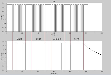

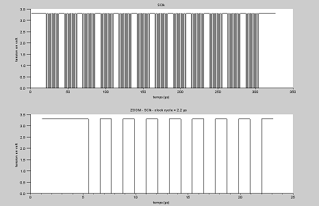

    I am always trying to have conversion results on SDO_A. As I cannot show any scope screenshot, I have approximatively reproduced the signals on SCILAB.
    The first picture shows the SCLK

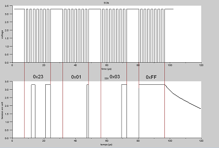

    The second picture shows SCLK and SDI (only the first 2 bytes). At the end of CR (SDI) the signal is decreasing slowly until 0V.

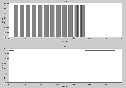

    The third picture shows the SCLK and the FS signal.
    Maelenn
  • It is better with the third one :

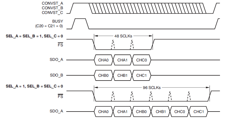

  • Hi Kevin,
    I receive some data now!
    But I only receive data from channel C (CH_C0 and CH_C1).
    I tried further values for the control register but I only got the converted data of channels C0 and C1.
    For the others, I receive 0x7FFE (whatever the input signal on channels A0 - A1 - B0 - B1).
    (For example I sent CR = 0x42 01 63 FF to receive CH_B0 and 1, without success, I still receive only the data of channels CH_C0 and 1)
    I tried to see the control register value in output too. But I did not succeed. (I sent 0x 02 03 E3 FF)
    Could you please tell me the value of the control register to receive all data (I tried 0x E2 01 03 FF) and to see the control register?
    Thanks in advance,
    Maelenn

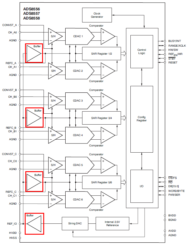

    In all of the configuration register permutations above, the internal reference buffers are disabled. We haven't really looked at your analog configuration with the device yet, but since you have the internal reference enabled I expect that you're attempting to use it. In the figure below all of the buffers highlighted in red are disabled if you do not enable the internal reference buffers:
    For any additional information about the internal reference and it's buffers, please consult the product datasheet. Specifically, page 25.
    With the internal reference buffers disabled I would expect that many of your conversion results are going to rail out and give codes that are full-scale. Try enabling the buffers and let us know your results.

    According to the datasheet of ADS8556 page 29, the internal reference source is disabled by default but the internal reference buffer is enabled by default, that's why I put this bit at 0. But as you recommended, I put this bit at 1 but I receive the same values as before.
  • Maelenn,
    You are correct, I forgot about the inversion of the buffer enable bits. I'll be checking into this some more tomorrow.
