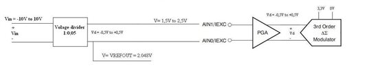

I'd like to convert a range of +-0,5 V with my ADS124 with unipolar 3,3-0 V voltage reference and power. To avoid putting a negative input to the device I thougt to measure the 0-5V using the voltage reference in the ADS, so my true input comes in range 2,5-2V aprox.
I studied the PGA and the ADC and I find this problem: if I use the AINp to measure, should I use the voltage reference in the AINN sol the input to the ADC is +-0,5V? In other words... Can I try to measure a bipolar range in ADC although I put a unipolar voltage analog input at the ADS?
I attach an image with my current idea and an alternative (although I don't really like it)
Which config should I use?

    For example, If you were to use the device with unipolar supply of AVDD=3V, AVSS=0V, you could use an external reference of 1.5V and attach the AINN to the external reference, this set up will bias the inputs close to the middle of the AVSS/AVDD analog supplies and allow you to convert the required differential signal of +/-0.5V across the inputs
    Can you please post the schematic or diagram of the circuit you are planning to use?  The image does not appear to be attached in the post above.

    Thanks for your answer and sorry for the inconvenience of moving my post. I read our links and this are my calculus:
    VINdifferential =  AINP – AINN = +-0.5V
    Full-scale input voltage = +/-VREF/PGAGAIN = +-3.3V         (G=1)
    VCM = (AINP+AINN)/2 => 1.75V < VCM < 2,25V
    AVSS + 0.1 + [(PGAGAIN)(|VINdifferential|)/2]  <   VCM   <   AVDD - 0.1 - [(PGAGAIN)(|VINdifferential|)/2] => 0.35<VCM<2,95
    Do these calculus say my design is correct?

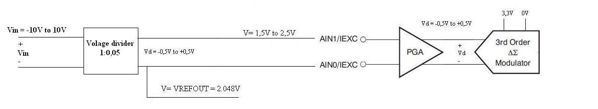

    Here is the schematic, I hope it's ok now.
    The idea is just add an offset to the measure. I'd like to use the VREFOUT in order to avoid using another external reference (final design price issues)
  • Hi Alexandra,
    Your calculations are correct and connecting the 2.048V internal reference  (VREFOUT) to AIN0 will work well with PGA=1; setting the device with the correct common-mode voltage.  The only issue is that per the datasheet,  the external reference input range needs to be 1V less than the analog supply voltage; if AVDD=3.3V and AVSS=0V; the maximum external reference allowed is 2.3V.  A possible option may be to use the internal 2.048V for conversion; since your expected input voltage range is +/-0.5V and you plan to use PGA=1.
