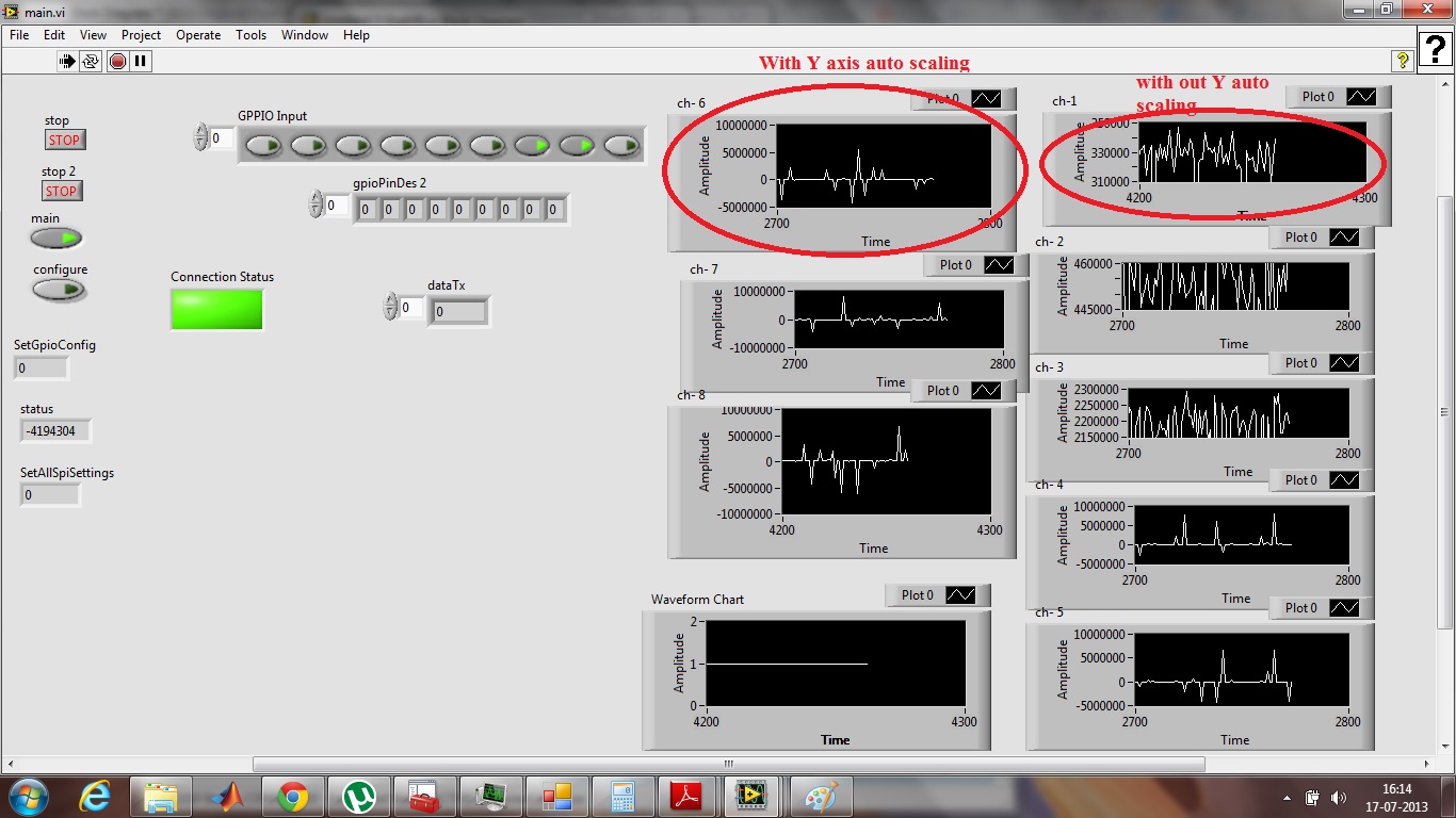

Thank you very much for last the information , we are using MCP2210 (USB to SPI Bridge ) to receive data with our labview code. can your labview code be used with MCP2210 rather then MMB0 motherboard to Communicate with ADS1299?
Thanks & Regards
Ikram Khan.S.I
Ikram -
The current LV code is designed for use with the MMB0. Without modification for the communication protocol difference, it will not work with other hardware.
It is open-source code though, so feel free to modify it as you need for your application.

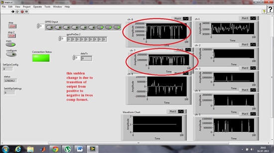

from my ads1299 i am getting 24bits per channel, since labview make it 32 bit integer datatype. 32th bit is considered as the sign bit,but actually 24 th bit is the sign bit. so my output remains always in positive(this is because 32 th bit is always zero). i have used some basic binary math i dont feel it to be efficient. is there is any direct method which i can use to directly connect to the filters and display the date in standard datatype. how to effectively use this 24 bit 2s compliment data in 32bit integer.
You have to sign-extend the 24bit data to 32bits. Most systems like numbers in 32 or 16bits (newer or larger systems can go to 64bits).

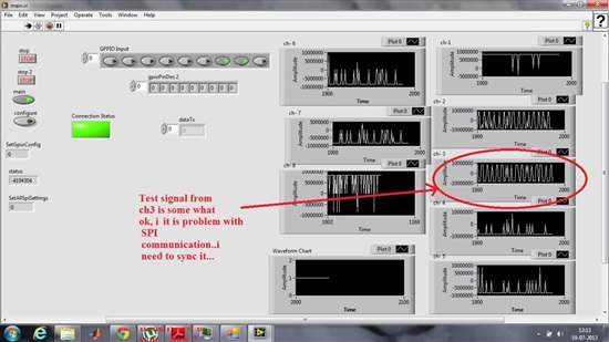

please Greg Hupp guide me on this issue, why i am getting noise spikes in spi communication.how to over come this problem.
Thanks & Regards
Ikram Khan.S.I
Ikram -
Have you tried using the internal test signal of the ADS1298 to verify that your communication is correct? The internal test signal would provide a known reference to verify that the problem is hardware related and not a software/communication issue.
how to synchronize my data fetching from ADS1290 SPI Communication, so that i can avoid this noisy spikes.
Can you provide more details? These would help us to be able to offer suggestions.
You should also review the various portions of the datasheet that related to data read to make sure you are reading correctly and meeting the timing specs.
