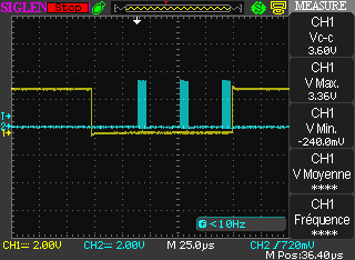

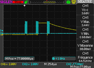

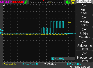

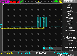

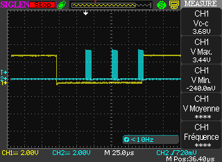

    Maybe I've a problem with the clock. I look to the scope and there is somethings strange. When I read the last byte. The Dataready go high before I the end of the clock. When I don't have the problem everything seems to be ok with the dataready. (The clock of the SPI is at 1MHz and is connected with a wire and pinheader)
    Here is the printscreen with the bug.
    Here is the printscreen where everything is OK
    And another strange things with the dout (yellow) of the adc

    Where did you probe SCLK and DRDY, was it at the ADS1255 or near your MCU?
    The signals look clean, but I'm curious if they look clean at the ADS1255 pins. You schematic shows a connector; might your digital signals be traversing a long wire?
    You could also be getting bad data if your MCU is not reading data out fast enough.
    If a conversion is completing while you're reading out data, you will get a corrupted result. Is /DRDY going high because of new conversion data (the /DRDY pulse should a have period of "1 / data rate")?

    When I have the problem /DRDY doesn't go high because there is a new conversion (The clock speed of SPI is 1 MHz and the datarate of the ADC is 100sps in this example).  It looks like after 18-19 bits the ADc stop to send me the data and /DRDY go high. But where are the missing bits ?
    I've an interrupt on /DRDY and I use the driverlib for the SPI
